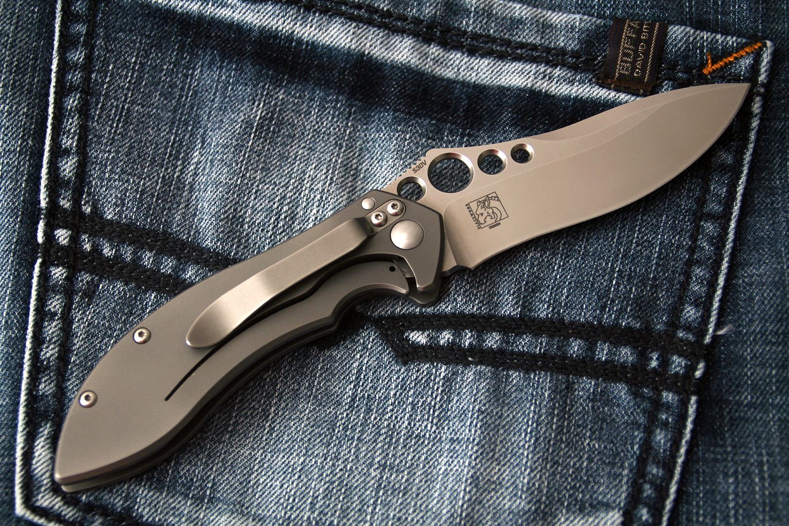

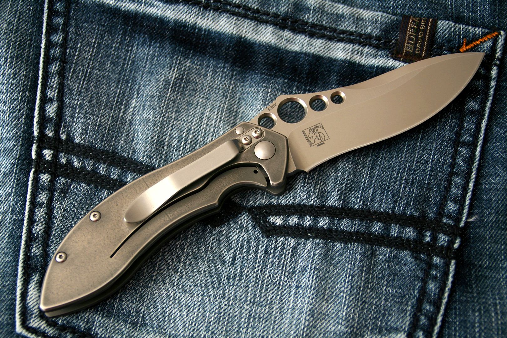

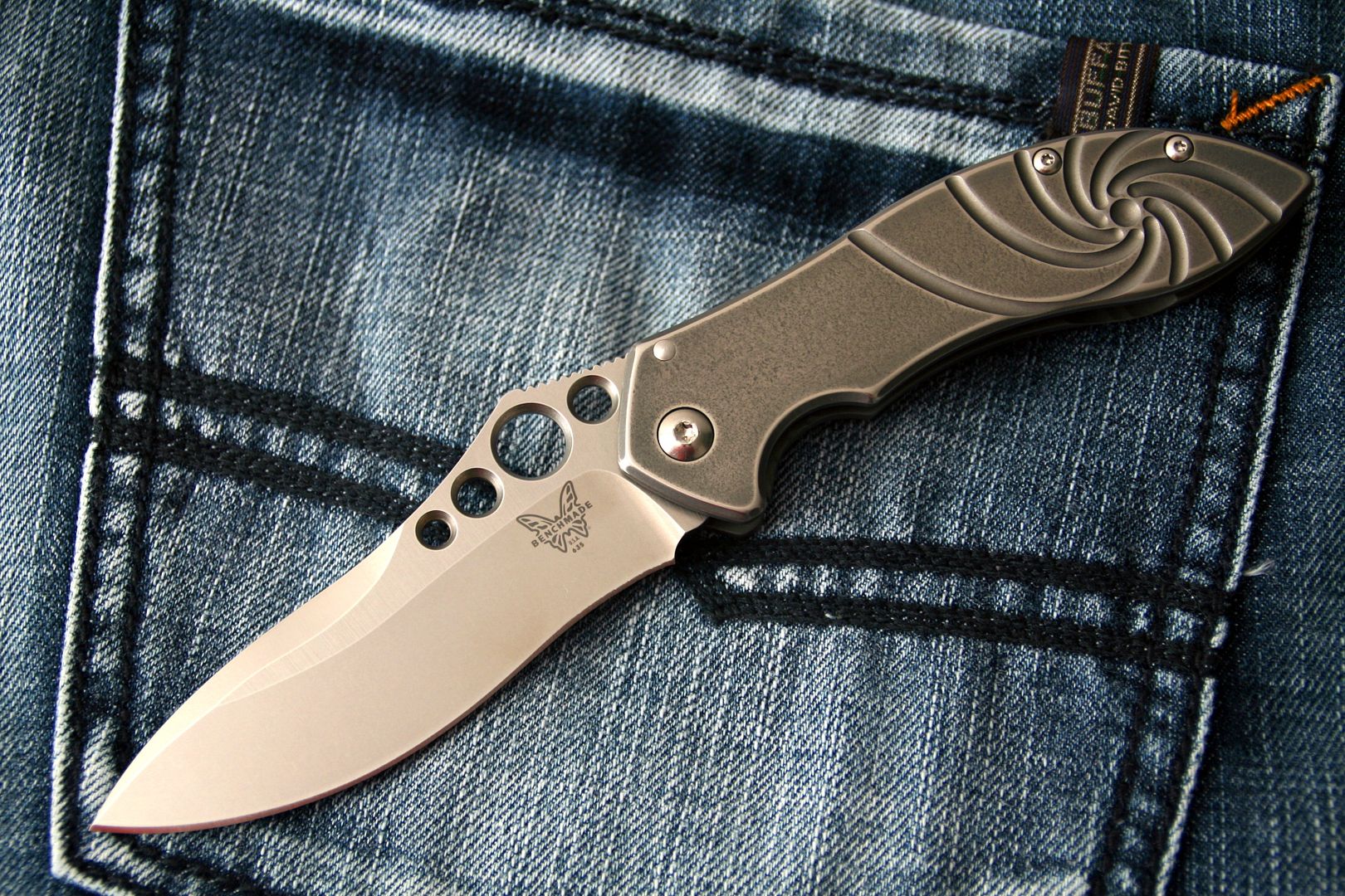

I was so pleased with the results, that I performed the same process on one of my BM Mini Skirmishes.
With the knife disassembled, I hand rubbed each scale with fine steel wool, then 400-grit, 800-grit, and finally 1000-grit WetorDry sandpaper.

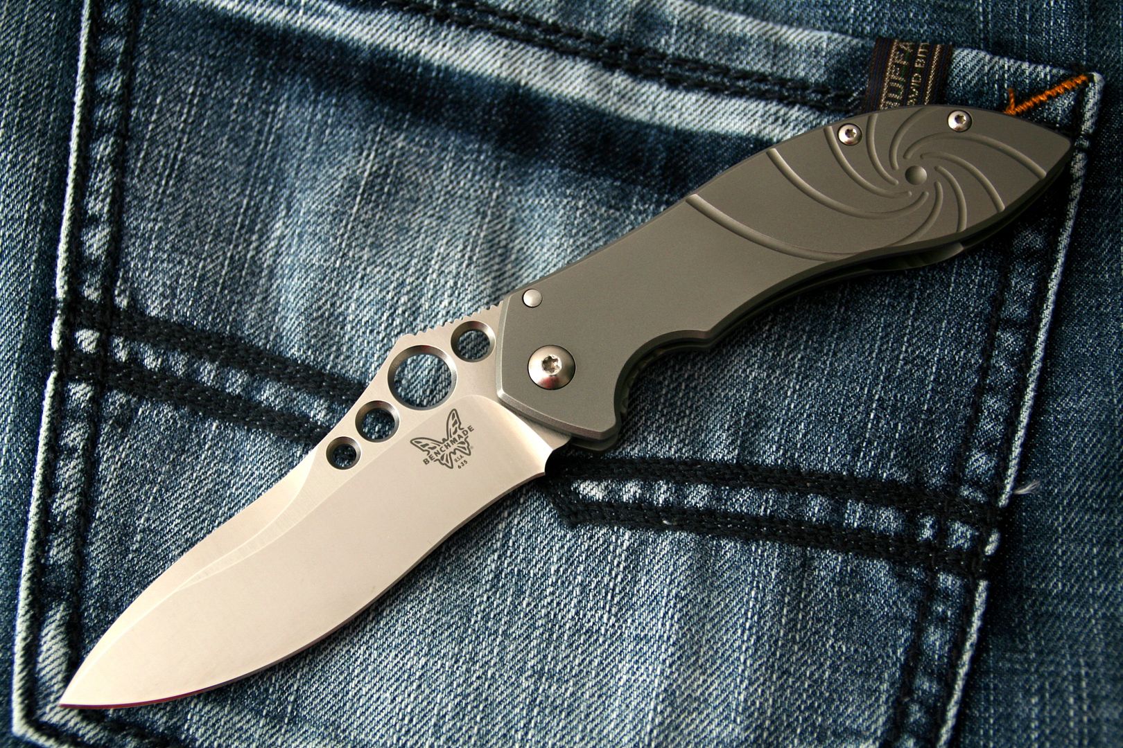

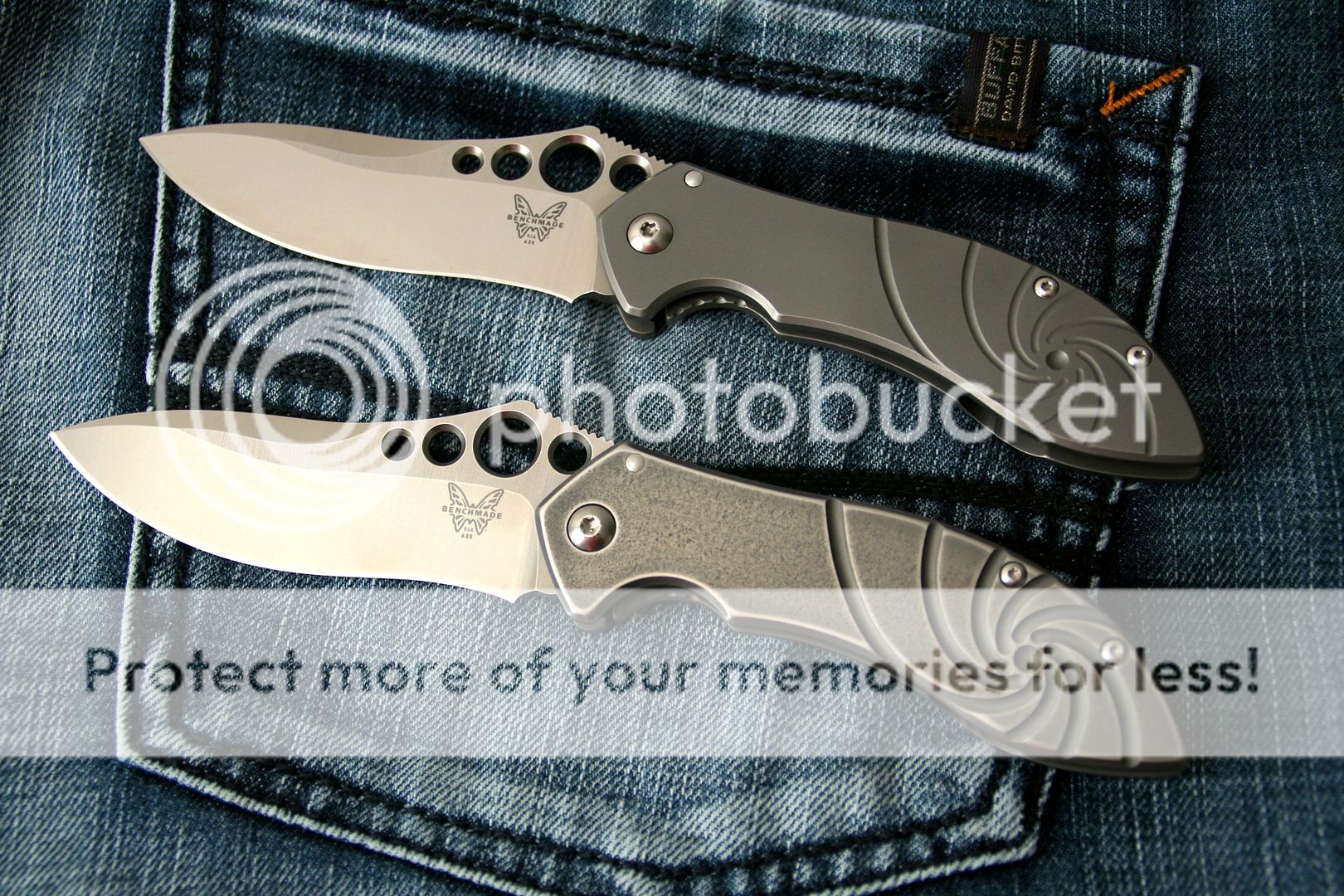

I spent about 15 minutes per grit per scale (2 hours total time). Here is the result (my other Mini Skirmish shown for comparison):
I would appreciate your comments - good or bad - about doing such a thing, and whether you would ever considered doing such a thing.
Thanks for viewing!

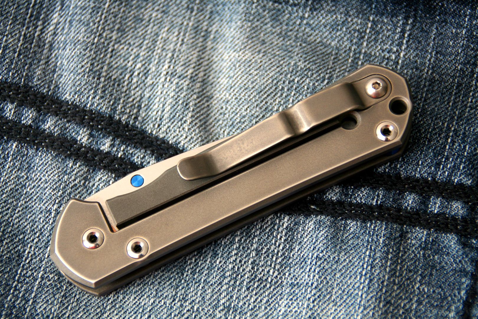

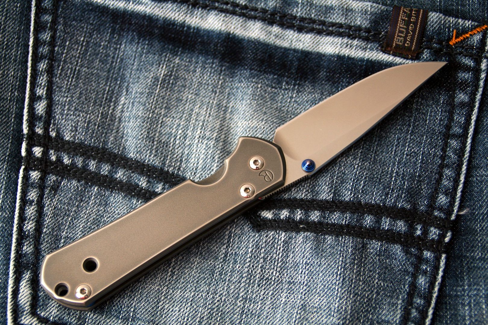

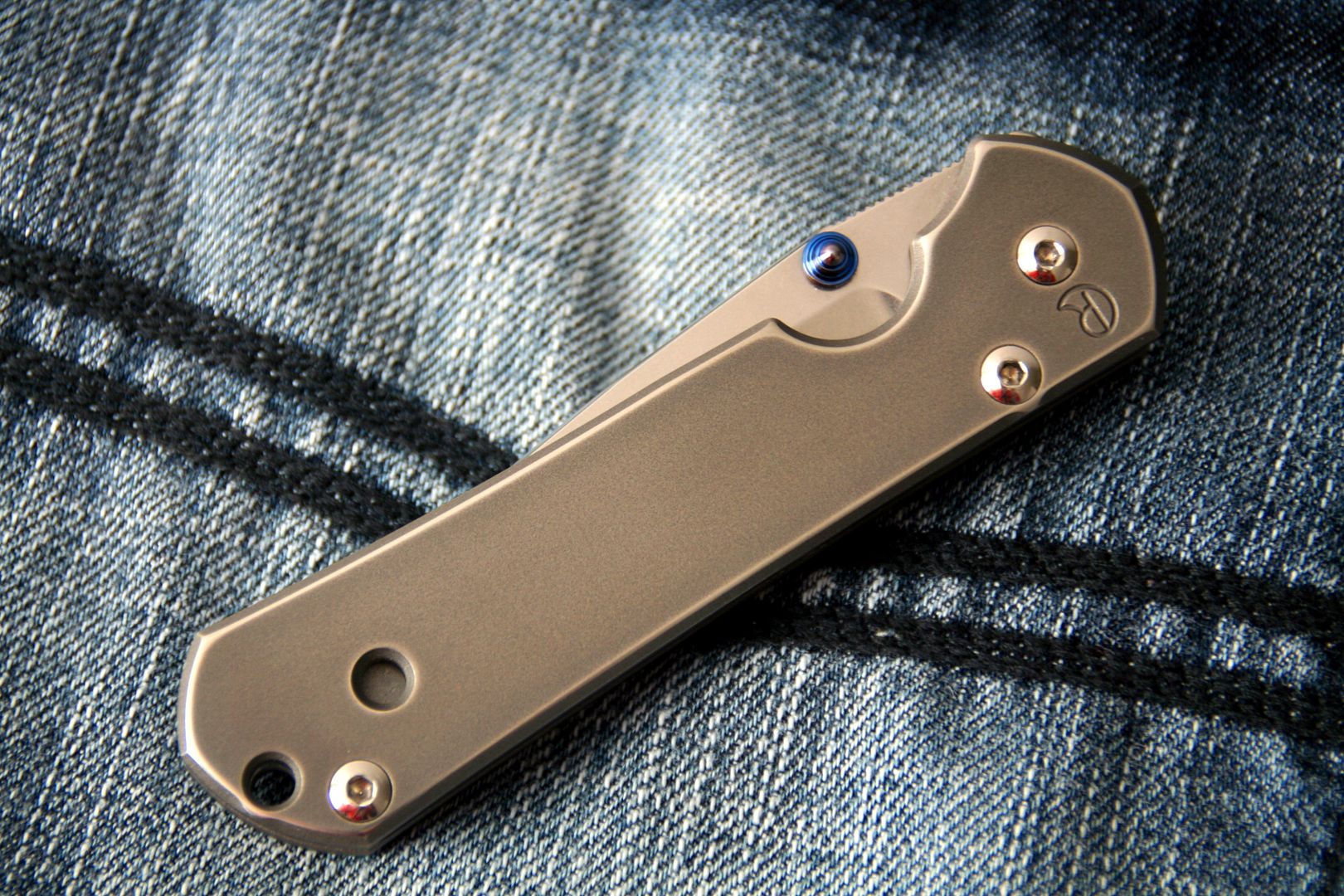

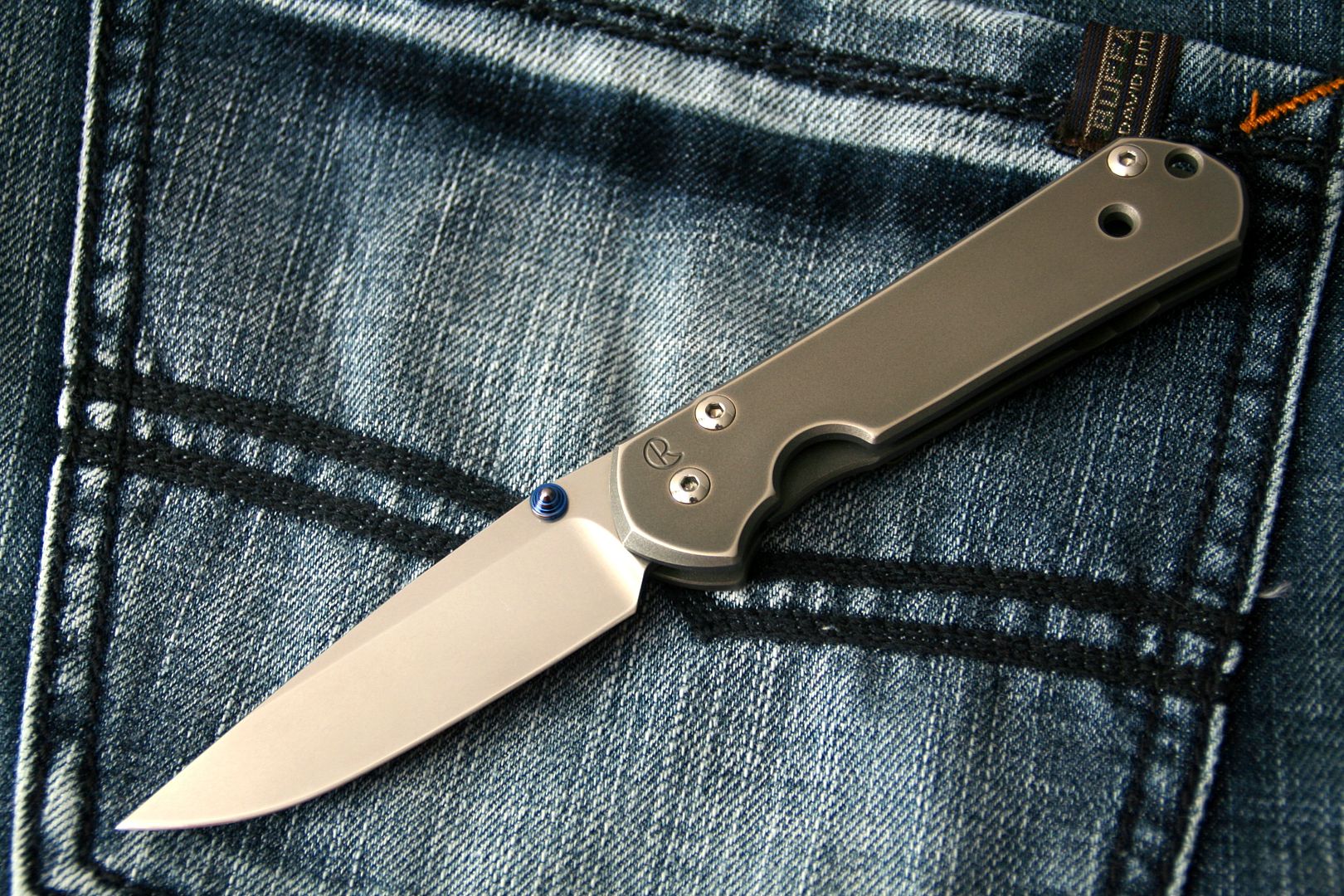

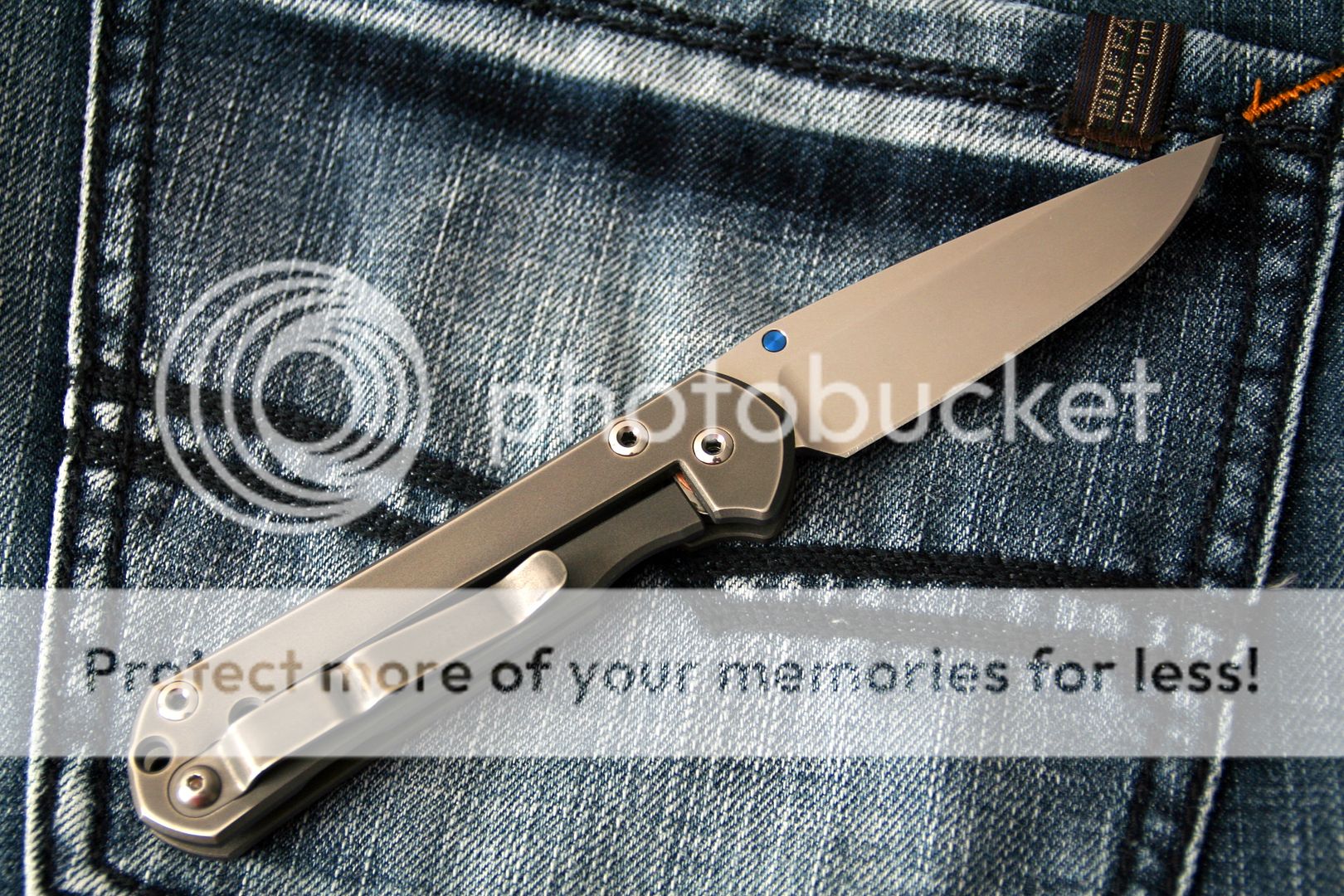

Thanks for your comments. I had to work up the nerve (couple of Heinekens, that is) to try this the first time. But since I only tried this with knives that I have two of, I figured I still had the original if I screwed it up! Here's the Sebbie:
I think it turned out well.
I like it much better on the Skirmish because the relief on the scales makes the effect more noticeable and dramatic.
On the Skirmish the machining looks much more deep on the one you worked on. Did you do something to do that or did it come that different? Just curious since I wouldn't think steel wool and some fine grit sandpaper would do that.

Thanks. That's how it came. I think the pre-finishing process is not as fine as with the Sebbie. I did the exact same thing to both the BM and the CRK, and you can really see the difference in the "fine-ness" of the titanium between the two.
