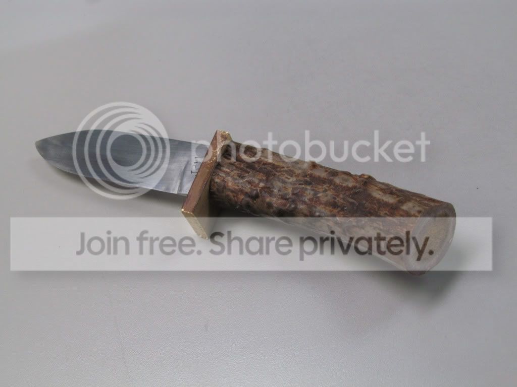

I epoxied this hidden tang knife I'm making for my boss last night. I still have a bunch of work to do on the finger guard and will be adding a brass pin through the handle but am looking for recommendations on what to do with the butt end. Can this be polished to look nice? Otherwise I have some thin brass I was thinking of exopying on the butt and secure it with some brass pins.
Thoughts, recommentations, constructive criticism?
Do you have a minds eye as to what you want it to look like?
Not much you can do with that pithy center in my experience.
I think a nice, polished rounded over butt would look nice, IF it can be polished to look good. The middle area is my concern; I don't think it will look good but I've never worked with antler before so I don't have much experience with this. This is why I was thinking of putting a thin brass cap on the end. It may also dress it up a bit too.
I like your brass cap Idea, maybe solder a piece perpindicular to the cap and grind out the soft pithy center of the antler and epoxy it into the end, should look sharp.

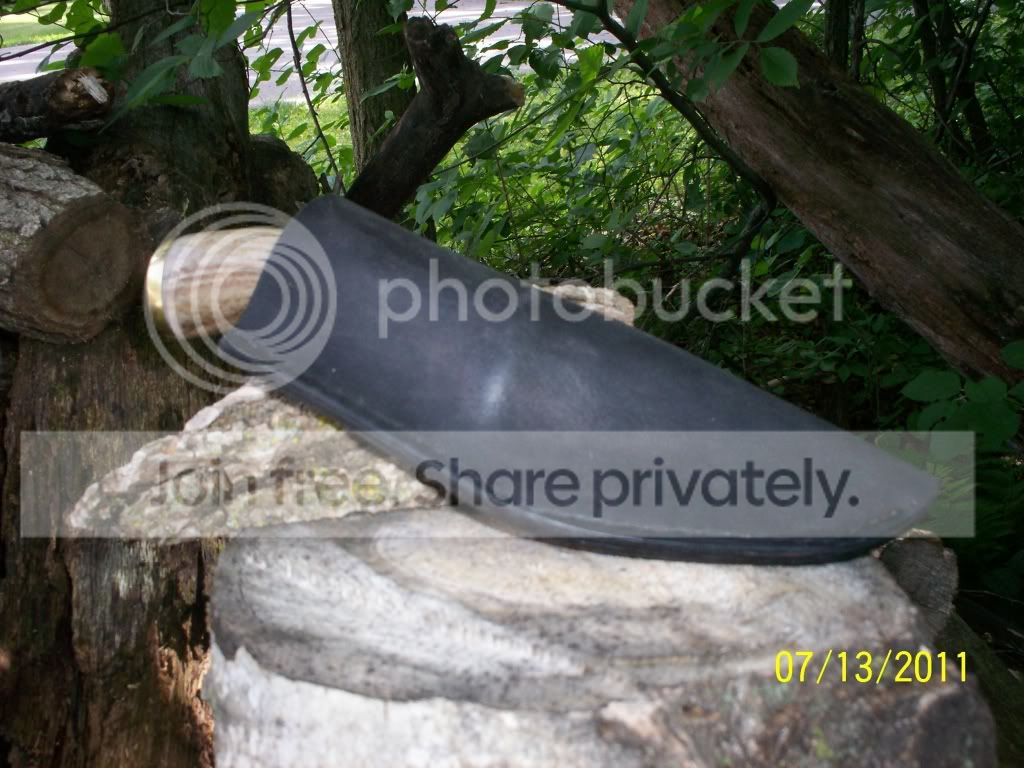

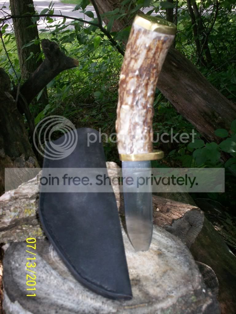

After months of laziness and some other hobbies, I've finally finished the knife. I did put a brass cap on using brass pins and I think it turned out pretty well. The camera used on these shots doesn't seem to do a very good job on close ups, so my apologies for the fuzzy shots.
Turned out very nice,Thanks for showing the finished knife.
Stan
