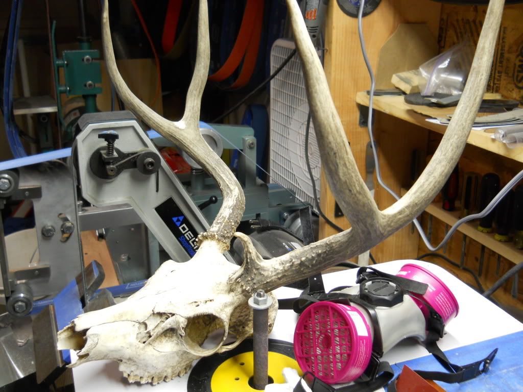

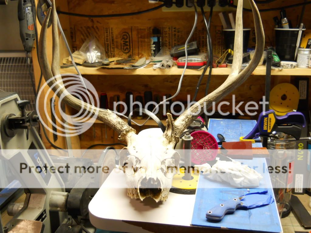

Here are a couple pics of the material he brought by today

IMHO, that is tooo cool a European mount to use for material. :o
Hang that in your shop (coat, broom, pellet gun rack... really anything) unless they are real adamant about using it. Or perhaps see if they have something else in their collection for the handle.
Scrap Whitetail and Mule deer antler is easy to come by.

Judging by the guesstimate of the base diameter of those antlers (I say they look to be 2.5-3" in circumference? about 7/8"-1"diameter) they would make decent stick tang rolls. Slabs would be AWFULLY narrow and very thick, IMHO. For good scales you'll need a much bigger set of antlers. base circumfrence of 4.5 - 5.0" will net you a scale that wil fit a 1.25" wide handle. Elen Hunting carries a nice selection of antler products. There are some who say you need to stabilize, & there are some who say you don't. I think it comes down to species. yours look to be from a Mule deer. It will be rather porous and pithy so I recommend stabilization for this species antlers. the link is to an article about different antlers and horns and working them. hope this helps.

I agree with Jason. I have a small amount of experience with antler, but it has always been from mature elk racks. Even then it is not easy to have enough diameter along with the length to make comfortable scales. The danger of making scales from something smaller is that the handle comes out too fat. I'm afraid this is not too encouraging, given the antlers you have to work with. You may just have to do a through tang instead.

Nice rack. Bigger than anything I've ever shot which doesn't say much for my hunting prowess. Anyway, your friend specified a SMALL skinner, and I agree with his judgment on this. Were I in your shoes I would be thinking along the lines of a hidden tang blade using a suitable portion of the antler sandwiched between a brass finger guard and a pommel.
If you jumped up in size you may be able to use the left side antler (when viewed straight on) cutting it off at the skull and using this part for the handle with the flared, gnarly bottom part being where a pommel would be. This might end up being larger than what he wants to carry around though.
