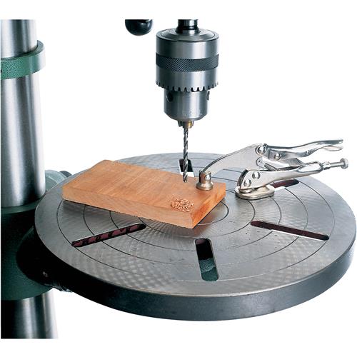

where can you get one? or how have you guys made em? I'm assuming some spring coil would be a good place to start.
i need something to hold down bar stock so I can hot slit. i tried modifying a drill press clamp to fit my hardy but it just isn't strong enough.

There is already a similar clamp sold as a drill press hold down.
Extend the threaded lug with a coupling nut and a section of threaded rod through the hardy hole of the anvil.
$11.25 at Grizzly
http://www.grizzly.com/products/Quick-Release-Drill-Press-Clamp-10-/G8079
i've got that same clamp... but my welds were pulling apart. i'm no genius with my wire feed. but did it again and it works lovely. it's becoming one of my better friends...

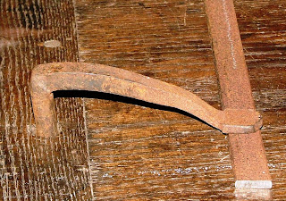

"lo-tech" version: you take a piece of rebar or other round stock suited to your anvil's pritchel and forge a sort of "L" with the long arm slightly bent so that, with the short end in the pritchel, and hammered lightly down on what you are forging, it holds it fast.
Something like this:
I prefer to forge a small ring on the "holding" end to make it easier to remove the whole thing (by tapping sideways on the ring).
