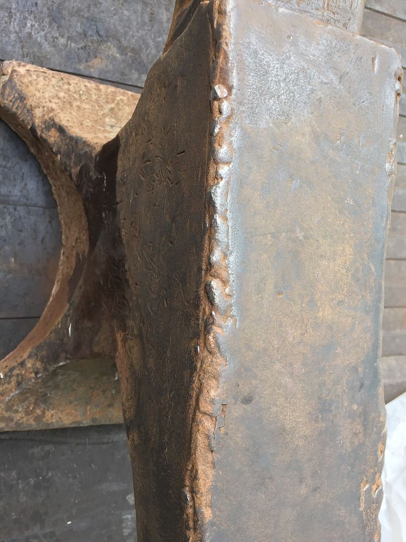

Hey guys and gals,

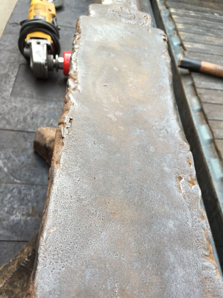

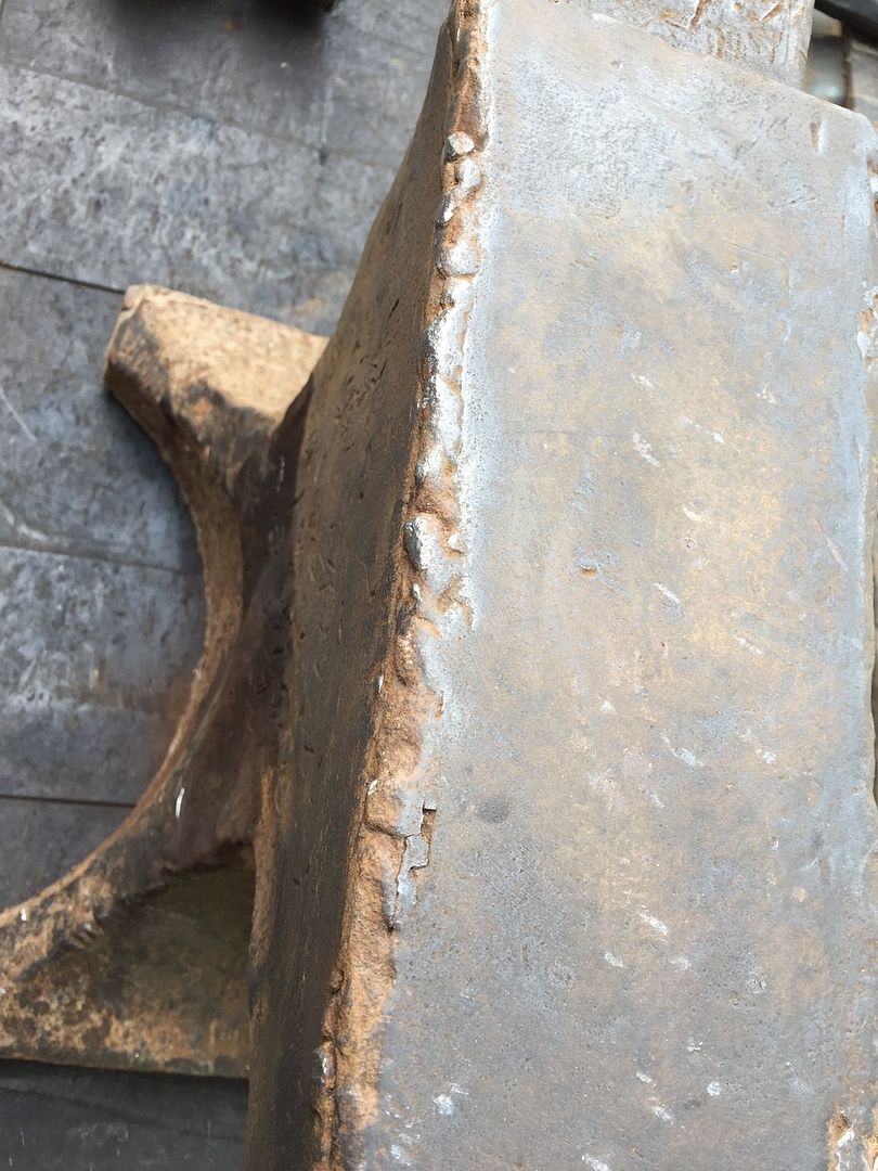

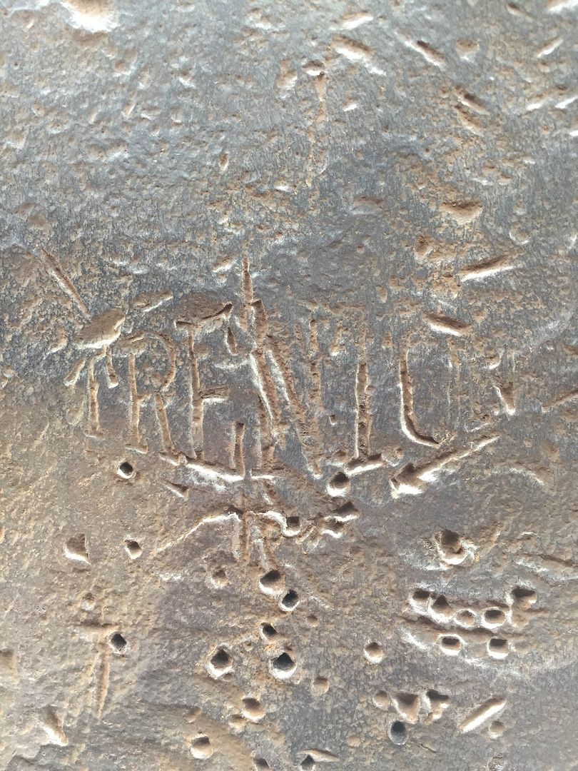

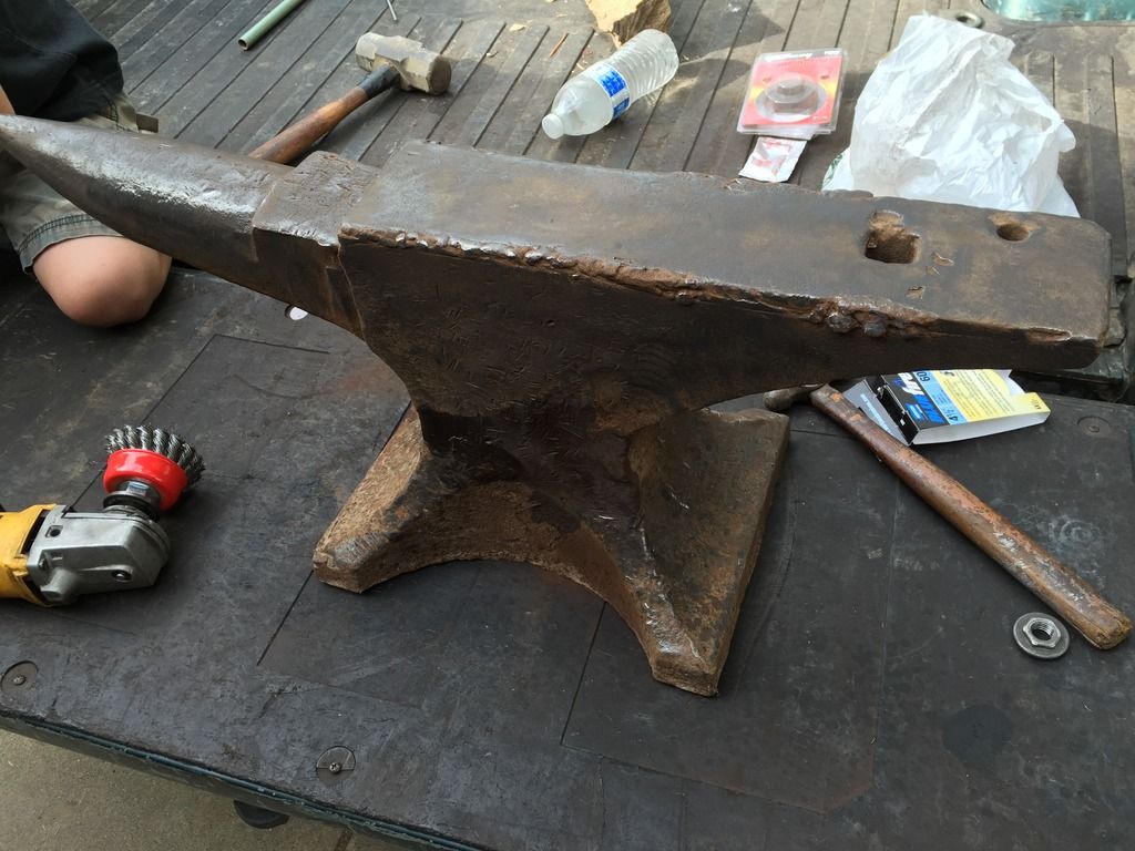

So I finally found an anvil after searching high and low. I was doing a trade for a vise from a guy on Craigs list and was talking about the types of metal working equipment I was looking for. He told me he had a friend that had lots of cool stuff laying around at his grandpas barn that he was talking about selling. We went over to his house and to make a long story short, Walla! He had this old rusty anvil sitting in the corner of the barn. I dragged it out into the sunlight to have a good look. He said he thought it weighed 100lbs and was asking $300. It was in pretty rough shape as the corners were pretty trashed. It looked as if someone tried welding on the plate years ago. I ended up talking him down to $200 as I couldn't see any makers marks and it being in such rough shape. I took it home and hit it with the wire cup brush and revealed the stamp. It is a 170lb Trenton. My question is what is the proper way to dress up the edges. I figured I could hit it with an angle grinder and clean it up that way being careful not to heat it up to much. This thing has such a beautiful ring!!! What should be the next steps to getting it serviceable. The face is in decent shape, I just need the edges cleaned up so I can have full functionality. Can I save this ole girl? One of these links should take you to the album.

Well if you forge in the typical horn left fashion a lot of your drawing will be on the off side that's in pretty good shape.
No need to do anything as has been said. If there are areas you find causing an issue a touch up on the edges with a flap disc on a grinder would be the most I would do.
If you need really sharp corners I would get a hardy block. In fact I was taught to forge and shown how to set the ricasso using a hardy block on an anvil that had great edges.

If you want a clean corner, consider grinding away some of the side, rather than thinking of building it up.
Sharp corners on an anvil are much more of a liability than a help, in almost every case- if you have one sharp spot you can use it on the rare occasions when you need it.
A flat face is more important, and it looks like yours is pretty good.
The more you forge, the less you'll worry about crisp corners.

I can't remember, is the weight of the Trenton Anvil on the left side of the front foot, and the date on the right side of the front foot? Nice Trenton, I have one of those as well.
Much like the OP's anvil it has the interesting hammer marks on the middle section of the anvil. It looks like someone tried to weld up the edge of you anvil's face.

The weight is on the right front foot of the trentons. I haven't found the date yet
If anyone figures those marks out, let me know. The off side of mine looks like someone spent an afternoon smacking it with the pick end of a slag hammer...must have been some common operation, always been curious what it was about.
Came from a country blacksmith shop in Yakima, where they did shoeing and all manner of other stuff.
I don't know that Trenton put the dates on their anvils, haven't ever seen one with a date, and I have several.
My hammer marks are pretty clean and visible. Due to the change in texture I suspect that it was assembled in three pieces; the face, the top half, and the bottom.

Give me the numbers on the right front foot and I can look up the year they were made. Anvils in America is the source. It also confirmed the three piece forged anvil and the reason for the hammer marks on the "waist" of the Trenton anvils

Some years ago I read about how a pick needs to be re-heat treated from time to time and when the blacksmith was finished with the pick he would drive the point of the pick into the side of his anvil to prove he did his job well.
Maybe someone can confirm this story I read?
