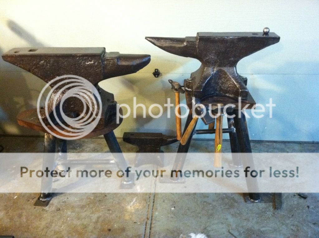

I bought my 300# Fisher a year and a half ago and just tonight got the stand built. :eek: :D
I built the stand for the 157# Fisher a couple of weeks ago.
Both of the base plates are 1-1/2" thick
The 300# anvil sits at 32-1/2" and is closer to knuckle height. The stand's base plate is 107#. The stand and anvil weigh around 425#. I have some rounds of W2 to strike down now!
The 157# anvil sits at 35-1/2". The base plate on this stand is 61#. I imagine the stand and anvil run around 240#.
The legs are splayed out at around a 8 degree angle with cross supports. 2" Sch 40 steel pipe legs with 1" Sch 40 cross supports.
Both take a lot of effort to tip. I can't anchor either to the ground in my rental house/garage, but the feet can be drilled later if desired.
I had the forge going last night to help a friend heat treat a blade. Tomorrow I fire it to forge a blade! :D
As both anvil's are Fishers there is no inherrant ring to be transmitted through to the stand. I used a piece of 1/2" thick heavy asphalt shingle to isolate any further transfer of sound.
If I owned a cast steel or wrought bodied anvil I would fill the legs with sand and oil. I still might drill a hole and fill the legs then tap and thread a plug in...
The pipe was free from work, if I was buying material I'd lean towards square legs as they are easier to mark and cut an 8 degree angle....
Fishers are designed in a way that they don't ring? I'm not familiar with them, but I like that idea.
Very nice. I might suggest mounting both on a solid piece of sheet to spread the load across the whole floor and for future anchoring to prevent turnover.
Yup. Fisher anvils are cast iron bodies. They patented a process where they weld the W1 tool steel face on during the pour.
You get more of a thwack than a ring. Vulcan anvils are also cast iron bodied but are hit or miss on quality.
Fishers are known as the "neighbor friendly" anvil.
I am going deaf in my right ear due to a machine I've run for 15 years so I purposefully searched for a Fisher anvil. Anything to minimize further damage along with proper diligence with hearing protection now...
I don't really see a need for a plate at the base. You have to really push to get either stand to tip. Eventually I'll drop a couple flushell anchors in the concrete and they will be one with the earth.

Adding sand with some oil inside the legs of a stand like these would help quiet your PW and Sodefors.
