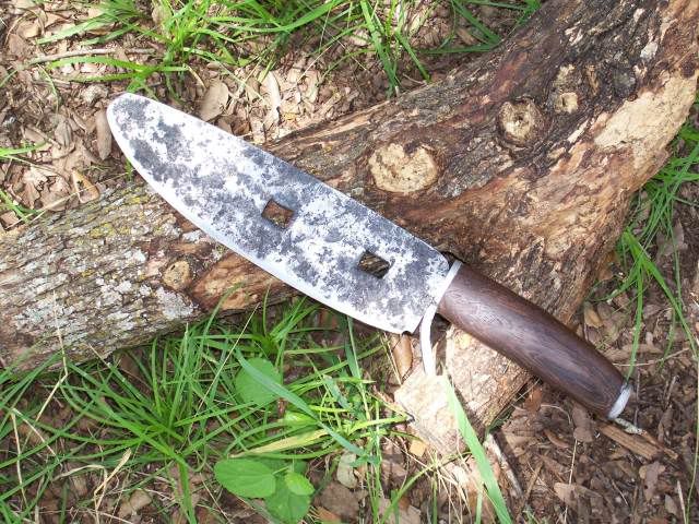

A friend of mine worked at a steel fabrication plant, and provided me with two pieces of 4140. This stuff is about 8" in diameter, 10" long.
I set it down in a bucket of concrete just like Tim Lively demonstrates in his video, and was able to produce this -
I don't have a pic of the anvil, though, just never got around to taking one. Beware, it weighs about 200lbs.!
