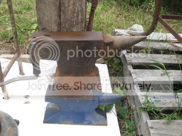

So after missing out on the Peter Wright anvil last week I have been searching for other anvils in the area and have found a few at local auctions, but what ones to try and get. I only want one and have a price that I am willing to pay set so if I get out bid so be it.

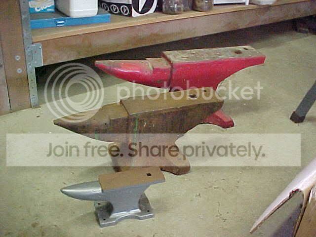

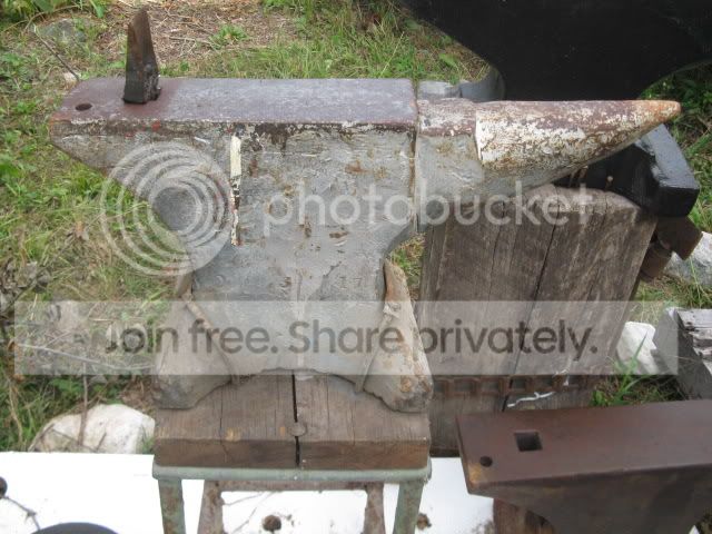

These three go on the block next weekend
They are listing 4 but only showing 3 of them weights are 140, 100, 90, and 40, but you can sort of see the fourth in the background of the bottom picture. I have no interest in the little one, but opinions of the condition on the other two would be nice.

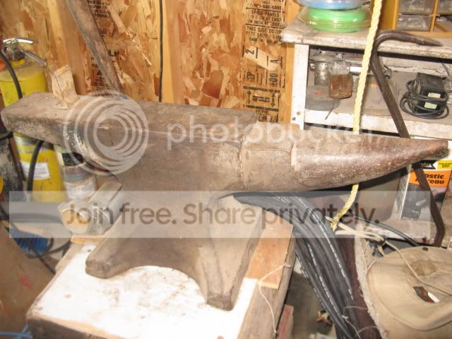

This one goes on the block the same weekend at a different auction and is listed at 150lbs
Looks to be in good shape but there is only one so I figure I may get out bid on it

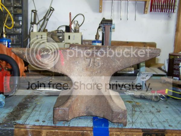

This one is marked at 75lbs but clearly the edges are in rough shape. It could go cheap, but is it worth it?
On the same weekend at and estate sale two of these are on the block, no weights listed but the back one and middle ones catch my eye

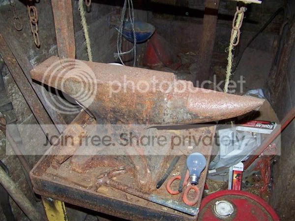

And finally there is this one, looks like it is just hidden in the back of a barn and hasn't seen any duty in some time. Looks like it is welded to the cart and the edges looked chipped and damaged to me, but if it goes for a good price is it worth getting and trying to bring back to life?
So what are the best ones I have shown? There is one more but there is no picture of it to show.
About all I know to look for is a fairly flat surface (no swayback) and sharp edges are good. There should, from my understanding, be a good rebound if you let a hammer fall on it from a short distance. I would think one around 100 pounds would be good yet still easy to move around.
Looks like one of them has a hot cutter with it. If you can get any hardie tools (and/or tongs, etc.) with the anvil, do it as they seem pretty costly.

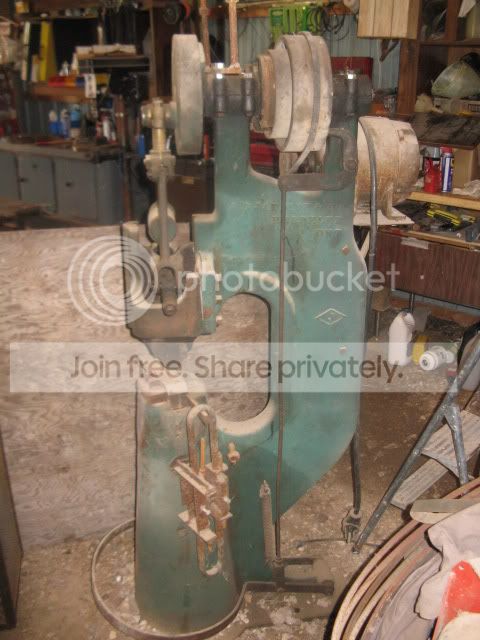

This is the list for the Blacksmith tools and horse section of that auction. Yes there is a Canadian giant trip hammer there, but I don't think I could afford it, and I don't have the room for it

  • Canadian Giant 25 Trip Hammer & Dies

Picture of the hammer
Of the ones posted, I'd go for either the larger one in the first photo,
or the 150 lb anvil in the third photo......between them would prefer
the third.
If you have the oportunity to check them over, take a ball bearing with you.
....1/2" to 3/4" in diameter. Use it to check rebound...drop the bearing
from a foot or less...it should rebound 90% +.
Anvil face should be flat...preferably...but many are slightly sway backed.
This can be ground flat...but would influence the price.
For forging flat stock into blades #100-110 is about minimum weight..IMO,
and would prefer heavier. If forging thicker stock....go for a heavier....it's
better to get one that you think might be heavier than needed, than to
get one that's too light, and regret.
I like the 150 pounder too, but with there only being one I think I will get out bid on it. Luckily it is the day before the first set so if I get out bid there are others to try for the next day
