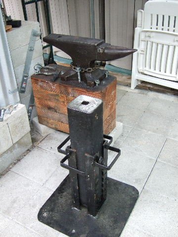

If I needed an anvil, this is what I'd build or buy. The one in the foreground.
Don, I've seen those, and they look really awesome, but I have yet to find a source for stock that big up here. I can get large round 4140 (no 4340 unfortunately Salem) from our local steel supplier, but it's horrendously expensive, and they don't do square stock at all.
