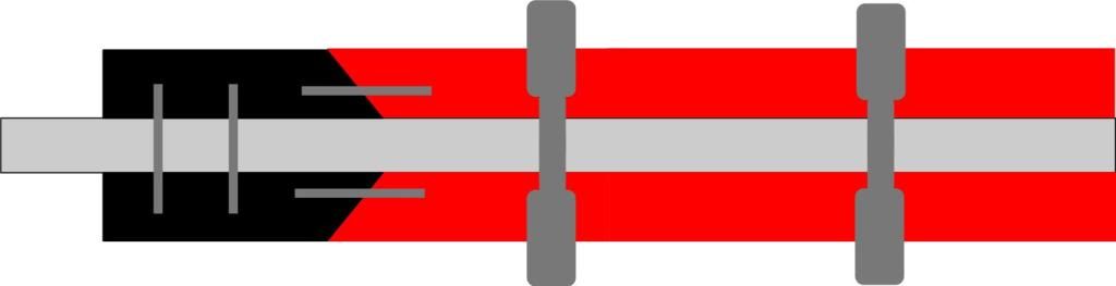

I am working on a set of knives for the kitchen and would like to use red G10 scales with black G10 bolsters. I plan to use loveless or corbys for the scales but won't use G10 bolsters unless I can find a way to attach them mechanically.
Sure, I love epoxy but don't want to use it alone. I know that with brass/stainless bolsters you can peen them on, but I don't want metal pins running through my black bolsters, and don't even know if you can peen onto G10 anyways.
Has anyone ever experimented with making G10 corbies, or something similar so I can get a mechanical bond on the bolsters?
If I can't get it figured out I'll use metal, but would really like to get this figured out.
Can you thread/tap G10?

I was able to get some micarta rod at the knife show in Ft. Worth this past saturday. What I am looking for is something that will hold the bolsters on without the aid of any epoxy at all. I will still add epoxy to seal the joint, but want all of the strength to come from the pins/screws/whatevwer. I would love for it to be uniform. In the back of my mind I am thinking "Black G10 Corby" and I know that no one sells them (that I know of). But am just wondering if they can be made and how well the threads will hold. It seems there would be a demand for something like this since more makers are using black G10 rods for pins.

I suspect machining your own G10 Corbies would be far more trouble than it's worth. Since you want a clean look (no metal pins showing) on the bolsters, here is my suggestion:
Drill matching sets of blind holes in the bolster material, and the scales, parallel to the blade. These will accept small steel pins that will mate the bolster to the scale on-end... sort of like dowels or biscuits joining two panels of a table-top or door.
Now, grind the back of the bolster and front of the scale at 45degrees each, so the scale "overlaps" the bolster. Often called a "dovetail" bolster (although it's not really a dovetail; more of a mitre, I suppose), this looks really cool. Assemble them together with SS pins in the blind holes you made and your favorite epoxy; you now have essentially a solid piece from which to shape your finished scale.
If this doesn't make sense, I'll make you a drawing. I thank you for bringing this up and making me think about it, I think it would look great and not sacrifice any strength in the handle.
Since you've already said you're going to use bolts to attach the "scale" part, and the bolster is held to the scale both by the hidden pins and by the scale overlapping it, I'd bet my grinder that it will never come apart.

I've done what James described using a cut, small diameter screw. I felt the threads would help strengthen the joint.
Haven't heard back from the owner in some two years.
James, is this what you have in mind? If so, it seems like it would sure work!
Jason
visually, I'd prefer it angled the other way, if you care :) oh, and that's a really short blade :D
dude its a kitchen knife not a tank! Horizontal pins are pretty difficult to do, especially considering that since it is a kitchen knife the scales will probly be pretty thin. But that would probably be one of the most thoroughly designed handles I have seen it should be indestructable.
I would prefer them to go the other way too, but I think this would give it more strength as the miter on the scales would help to hold the bolsters down. If they were mitered the other way with the bolster on top then only the pins and glue would be holding the bolsters on. This way the scales, pins, and glue are all working to hold them in place and the only way they could pop off would be at a diagonal towards the blade.
