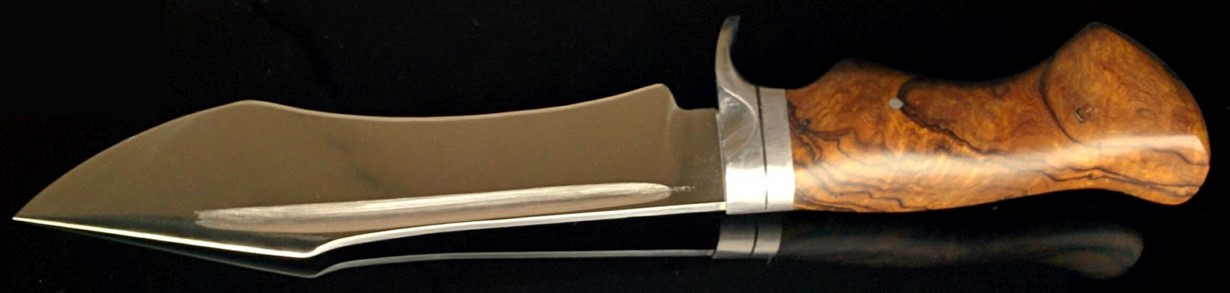

Here's my version of that same of that same fullering scraper. You can grind any shape of scraper for it out of lathe bit stock. Fullers can be blended up to the surface easily enough. I recommend EDM stones for finishing afterwards.
Test cut on mild
Kukri in 80crv2 with scraped in fuller

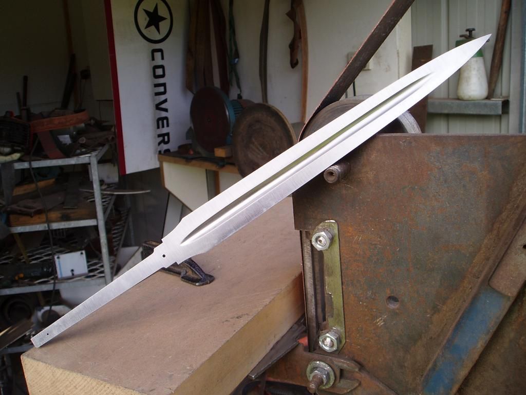

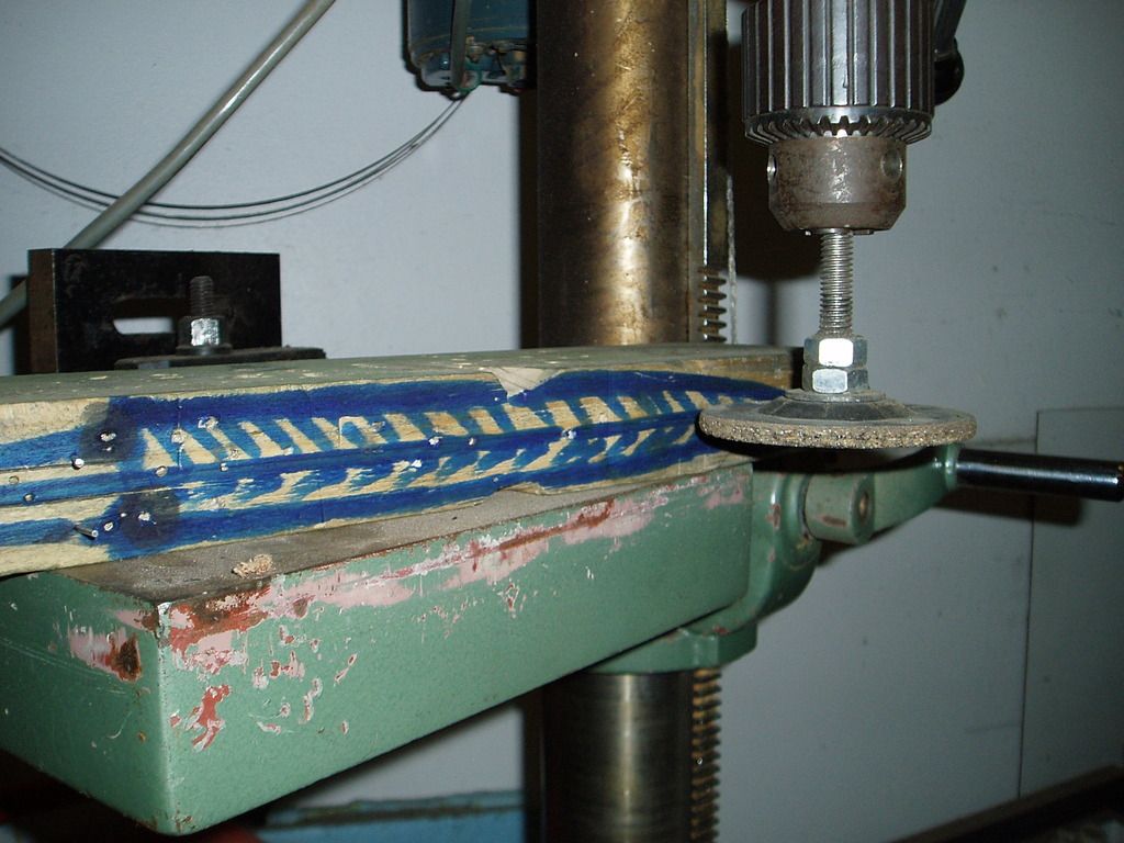

Scrapers at by far the best method if you want to follow/mirror the spine profile (eg. tanto) If you want to cut a fuller down the middle of a blade (eg. dagger) I find it easier to grind it in. Using your drill press and a simple arbor made using a 1/2" bolt, you can mount various thickness angle grinder disks to cut your fuller.
Screw/clamp your blade to a piece of dressed hardwood, mark a center line on the timber to help you line it up. Adjust the drill press table so the disk is cutting at the right height and using many passes cut the fuller in. Regularly round/dress the edge of the disk to maintain the profile of the cut. I find it best to cut the fuller in before grinding the bevels.
Cleaning the fuller is same as mentioned above, shaped slip stones followed by wet and dry around a mandrel. Keep in mind the disk will cut a channel a bee's dick wider than itself. Also lateral pressure on your drill press spindle over a long time (years) can cause undue wear.

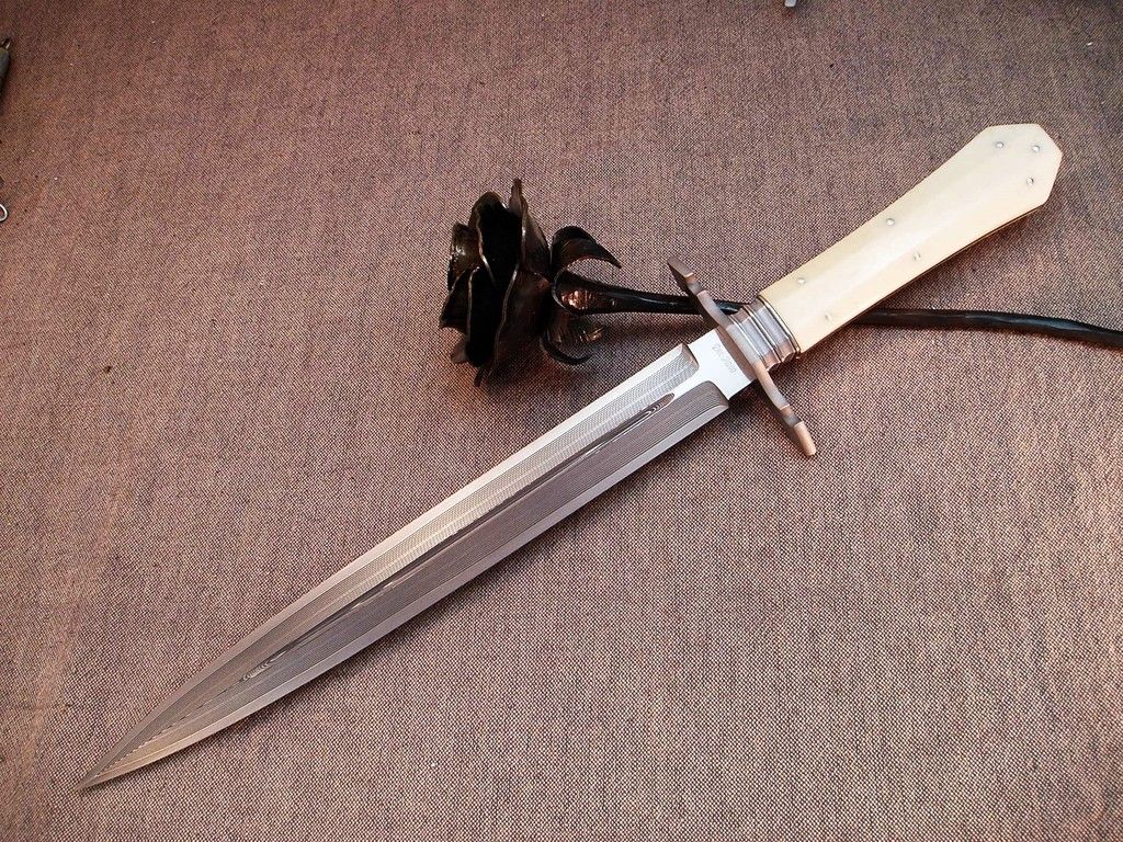

Del Raso: That looks great on the dagger!
Stacy, I for one will appreciate if you do manage to detail your process in a WIP.
Yeah, that dagger is slick! You can also mirror that grinding technique, but instead of the drill press, fabricate an adjustable spacer that clamps onto the "guard" boss of an angle grinder, then use grinding discs with a profiled edge to get long fullers into a sword blade. Works if the fuller follows the edge.
You can always clamp the blade to a piece of bar stock for a guide to follow for a straight fuller on a profiled blade.
That blade(s) is sick. But if your cutting in the fuller befor you grind the edge bevels then you could even go ne step further and scrape them in befor you profile the blade. If the blade is straight bar stock it would be easy to cut a center fuller the length of the blade.
