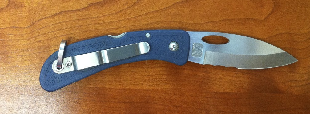

Decent full tang knife for under $50 with some stainless super steel is not realistic . The above worked fine for a long time .:cool::thumbsup::thumbsup:
