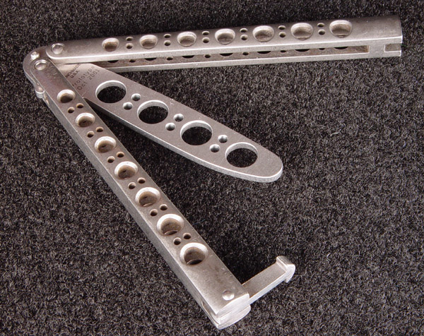

It just occured to me that with my fancy new digital camera, I can go from the studio to the web in minutes.

Thanks Chuck. Nice pic as always.
But I can't tell from the picture what would give the 40T's handle "more purchase", other than a flatter surface texture that would suggest a rougher finish than the standard stain series. Any hints you can share?

The handles on the 40T are the same handles as on the 42/3/7. The difference is simply that they don't post-polish them. They're just as they come out of the casting mould, just a little bit rough. I really don't think it's that big a deal. I don't think that they are significantly more "grippy".
Omitting the post-polishing process reduces cost and is one of the ways that BM can offer this trainer for less than the cost of a live knife.
