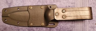

While I thought the sheath detent is overly tight on the knife (even with the slide screw backed off) and wouldn't allow the knife to be drawn when on a belt, I just tried it and it is ok. You just can't baby it - you have to pull fast with a good grip.

Anyone have any input on the belt attachment? I have had a plain edge 6 for about 4 years now (great knife) and the first thing I changed was the clip plate. I just ordered a cm6, and am trying to find some good belt attachment options. Has the clip plate worked well for y'all, or is there something else you prefer?
