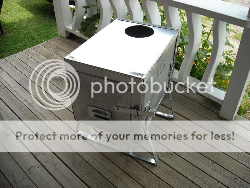

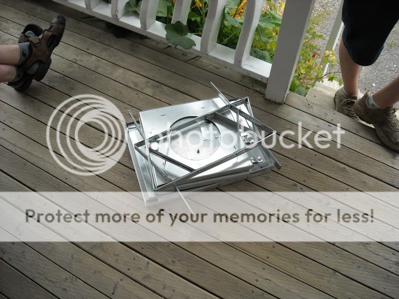

Here is one my brother and I made for the wall tent. I just shovel some sand into the bottom of it to protect it from burning out.

Here is my home made tent/camping stove. It started life as a 5 gallon oil pail. It's heat is quite welcome on a cold evening.
