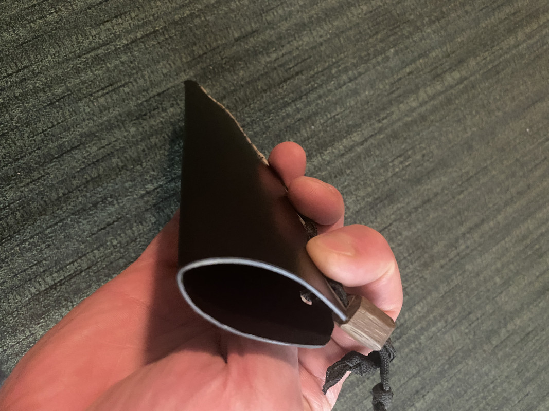

I have a bunch of experience with leather, but I figured I’d try something different. I picked up a bit of this from FortyTwoBlades FortyTwoBlades and figured I’d give it a try. I’m used to 9 oz leather, so I know a little bit about working with stiff materials, but this stuff is stiffer. Can’t make it pliable with water, so I figured I’d ask around and see what people use or how they work it.
I’m interested in making a simple taco sheath for smallish fixed blades.

It’s a pretty tricky substance to work with, but I can attest to the fact that it makes a decent sheath, and I like the price compared to leather. This one is weltless, which is not something I’d normally consider, but this stuff is so stiff I think it’ll hold up.
Heck yeah--great result for your first attempt, no less! And yeah it has some eccentricities to it, for sure, but a lot of advantages as well, not the least of which is the low cost! It does pick up cosmetic scuffs and scratches fairly easily, but once it gets enough of them it has a lot of character, almost like building up a patina on carbon steel, and has a nice industrial look.
Another thing I like about this material is that it always flexes outward. Sheathing the knife doesn’t feel like it could cut or stab through the sheath. It stays out of the way. My leather punches worked great on the stuff, too.
Saddle stitching it was a real pain, because it’s less forgiving than leather, but if I had found my speed stitcher, it wouldn’t have been a problem.

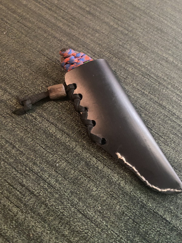

Yeah I recommend chiseling the stitching holes and glover's needles, possibly with rubber-jawed pliers. I typically suggest facing the concave faces of mating panels together for the tightest and most attractive fit.
The stitching is currently a little proud- I typically cut the leather to allow for the thread in areas where the thread will be rubbed by the knife handle.
I'm wondering if I can't use some kind of cold chisel to make little valleys for the threads?
I'm going to try it out on a scrap and see if it works.
Because of how thin it is you might struggle with doing that without causing distortion, but it's also the reason why I normally would use a flat-backed compression rivet or two in that context.

Won't scratch, and much more flexible/easy to work. It's like a very stiff leather. The only way it'd scratch a knife would be if something scratchy somehow got down in the sheath, and then it's not the material at fault for doing it. If anything, the PetroCor is the material that's prone to scratching, but like I mentioned once it gets enough of 'em it has a nice industrial look. You can heat-mold it like Kydex but it isn't necessary, and more commonly I'll just take a heat gun to certain zones of it when I want to remove a bit of pinch or to flatten a fold. It can be cut with sufficiently sturdy shears (I use my Humboldt shears to cut it by hand) but is something like easily 5x more difficult to cut than leather, especially with glancing cuts like from a knife being drawn from it since it's sort of self-lubricating and makes the knife slide more than bite in. While I'm unsure of the hardness of our particular material, the Shore hardness of HDPE ranges 63-67 on the D scale while Kydex is 77.
