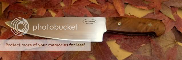

A chef knife is a good place to start, simple shape, thin so not alot of material to remove. I highly recommend stainless with outside heat treat, because they will bend. The pros will return it to you straight. 1/8 is more than thick enough, 12" long is nice, 1 1/2 wide and you are ready to go. Flat grind, files and sand paper will do the trick. This is a pretty straight on shot, print it full size on 81/2 x 11 and you have a nice templet. For the handle , get some thin wood, drill pin holes, glue it on, shape once its dry in place, just make sure the front is lined up as you like.
