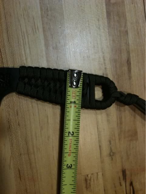

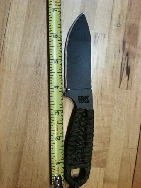

Thanks guys. I am just wanting to order some wood scale blanks and since my knife isnt in yet, I have no idea how wide the blank needs to be. I figure a 3/8 x 2 x 6 size would probably work, but wish I had a measurement.
