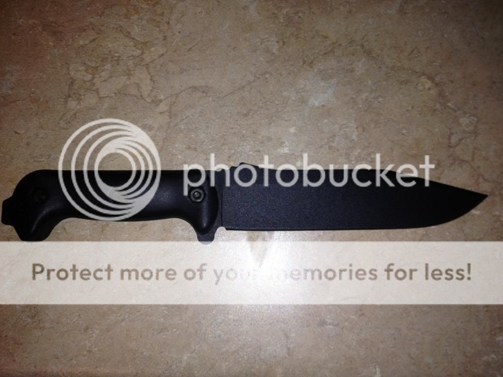

I laid out my BK7 and took the factory handles off.

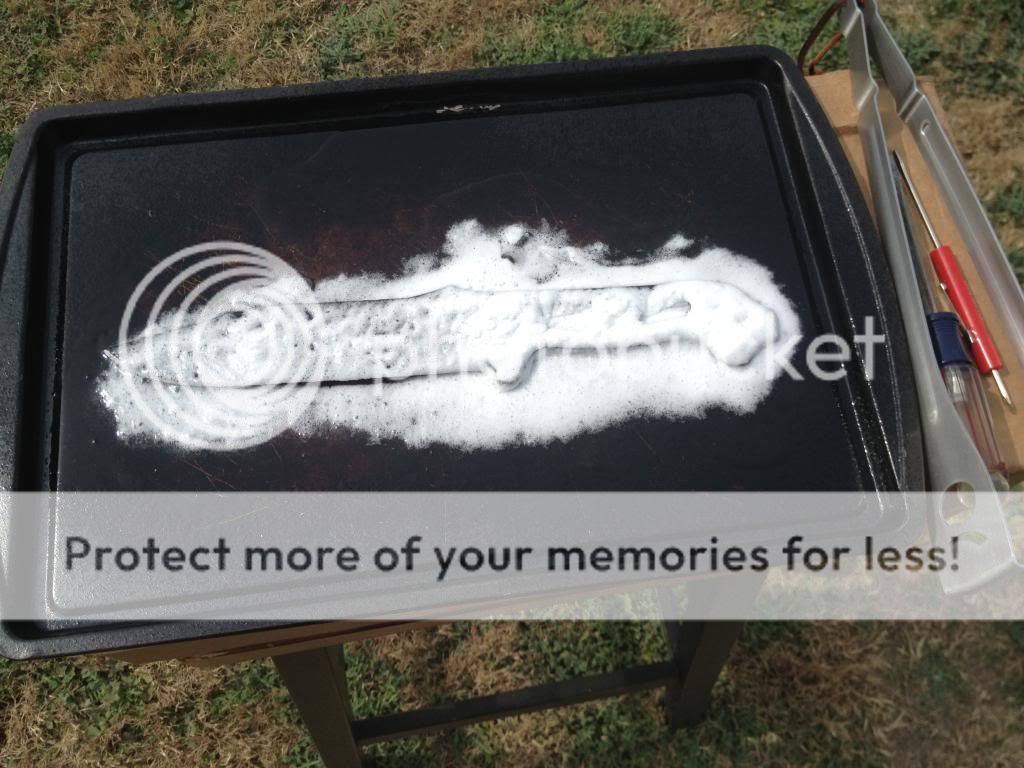

I got my saftey glasses on and had a brand new box of nitrile gloves at my side. Tongs and screwdrivers to flip and hold the knife with and razor blades for scraping! I special ordered the Jasco product that the guy used it the video and referred to as "Alien Blood" because I wanted this to be a super easy process.
Let's get this party started!

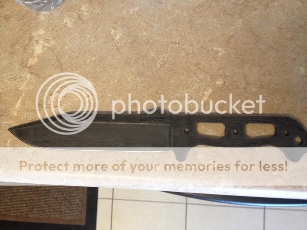

I should have taken some shots during the process but, things didn't go quite as planned. After the first 15 minutes I started scraping and the coating was coming off, but nothing at all like it did in the videos. My blade didn't appear to be a shiny polished blade at all! So I did a second coating and got a very tiny bit more coating off where I had missed at first.
So it's not at all what I was expecting and I have absolutely no idea what happened or if I just have a different generation knife, if I did something wrong, etc. I have no clue. It's not terrible I guess though...
I ran the razor over all the edges (not the cutting edge) on the blade which kind of cleaned up the lines. I also rubbed down the knife with some Break Free CLP since I don't know if this is still considered coated or not, haha. So after doing the dishes, I checked online and saw that the scales had been delivered. I ran down the street to the mailboxes and grabbed the package, not excited as I was this morning because things did not go as planned at all but, I was still excited to put them on because I was sure they'd be more comfortable then the factory Becker handles.

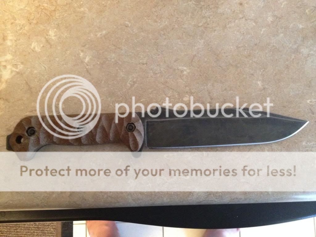

Boom!
Again, this is not at all what I had in mind when I woke up this morning. I am pleasantly surprised though! I think it looks badass!
If anyone has any insight into what could have happened or why mine isn't the normal polished blade that I see in all the pictures of others who have stripped the coating off, please reply and let me know what you've got. I really ended up liking the way it looks though. All in all this was a success in my book and I'm really happy with how it turned out! Now I just need to get a better sheath than the factory one! To kydex or leather...

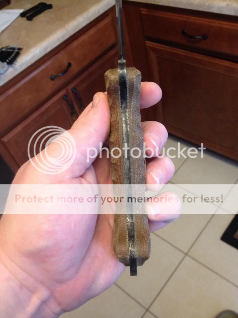

The handle was even more of a pain than the blade...
I think it looks better like it does now than if it had a polished look to it.

Yea, I've stripped about 25-30 Becker's, and most are pretty ugly under the coating. That's one reason they coat them, to save on money. Sometimes the steel is colored like that from the steel mill. Just get a pack of assorted automotive sand paper and work your way up, 400 thru 2000 or 2500 should do it. Might take 30 or 45 mins. Or just leave it? It's all personal preference.
You did everything right. They look like that under the skin. The pics you are seeing are after they take some medium then light grit sandpaper to the blade after the stripper.
Personally I just use 800 or 1000 grit then bump it up to 1500 grit and a half hour of elbow grease and you can get a decent satin finish look. I also use a dremel and a sanding wheel to do the contours and back of the blade and handle areas.

Haaa. That's my picture of the pretty BK7 in the original post. I can tell you that I spent a significant amount of time with scotchbrite to get it looking that good. I miss that one.
And....it was a Camillus BK7.
In my experience the few Camillus Beckers that I have stripped have been much "prettier" than most Ka-bar models that I've stripped.
The Camillus blades had a better finish under the coating. Much smoother.
Mystery solved?...
Anyway, the Ka-bar models will (just like the others have said) clean up nicely with some sandpaper and elbow grease.
