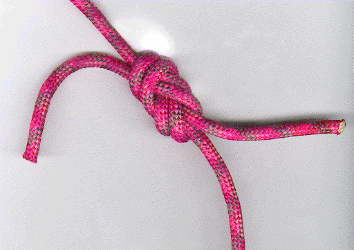

I think that the figure-eight knot is dependable for joining two ropes of the same size. I use them a lot during rock climbing or caving.
Not to nit-pick but if you want to join two ropes of the same size the fig-8 bend is what you want.
If the rope is synthetic a hunters bend or riggers bend with two half-hitches (half-hitchs not shown) is a better choice.
I agree that the figure 8 backed up with two half hitches is the best. Our Fire Department has also used a double fisherman with half hitch back-ups, but only for low angle situations.
