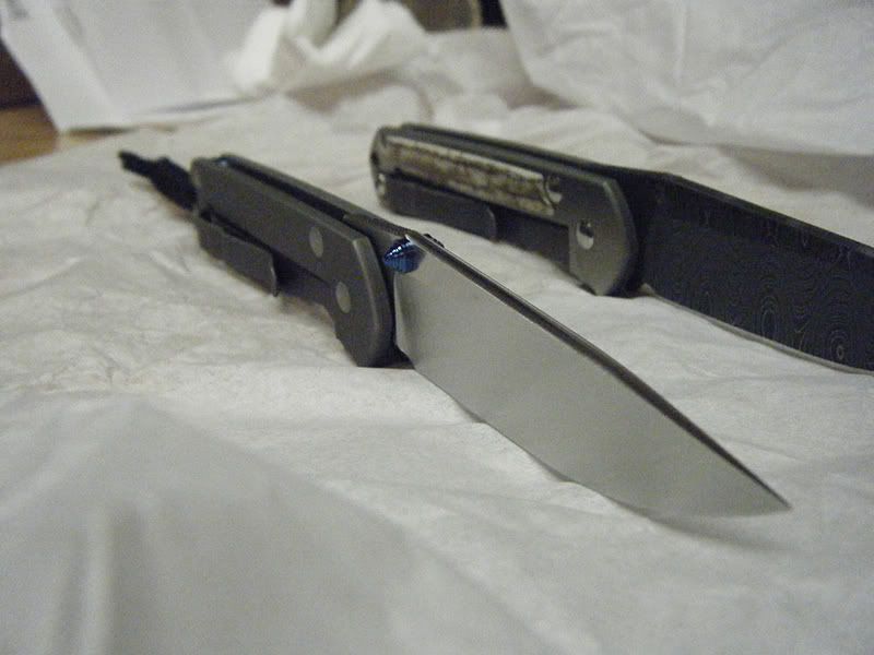

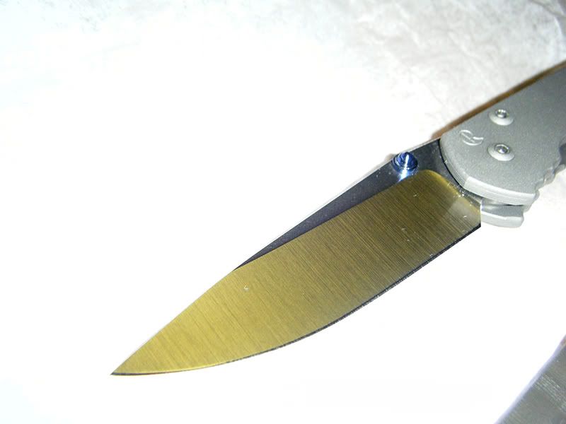

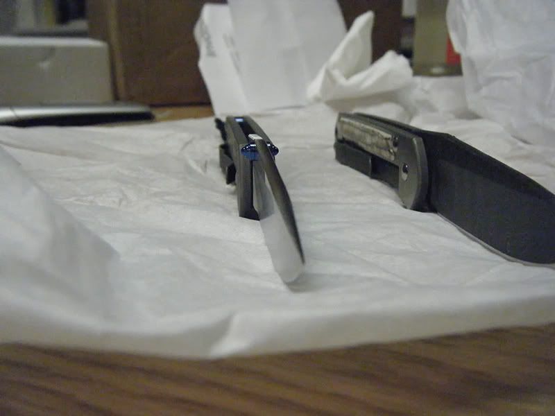

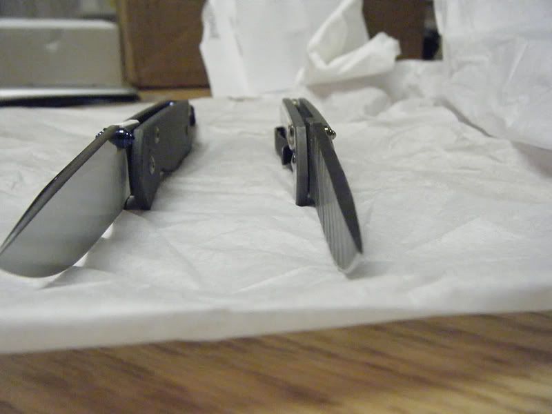

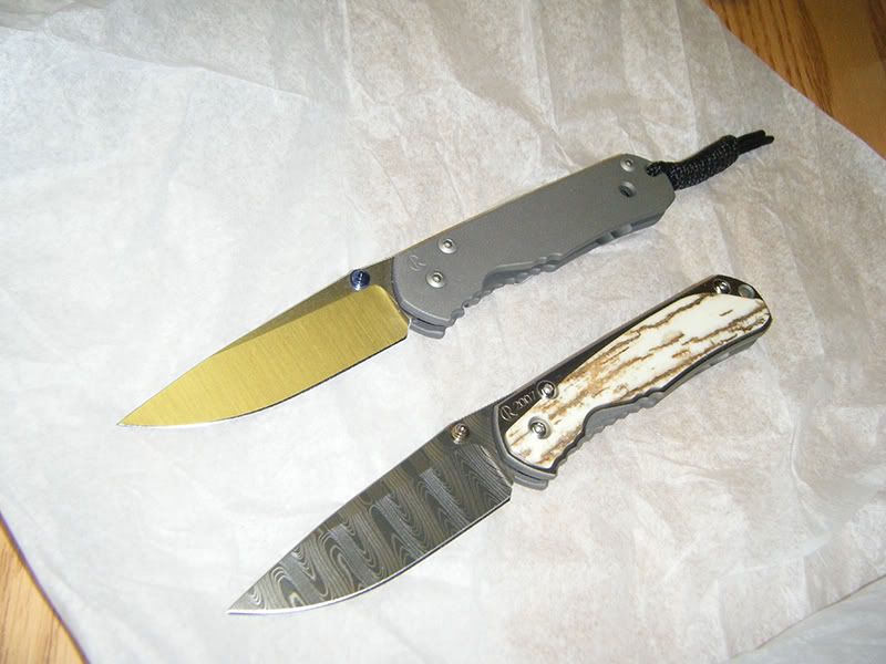

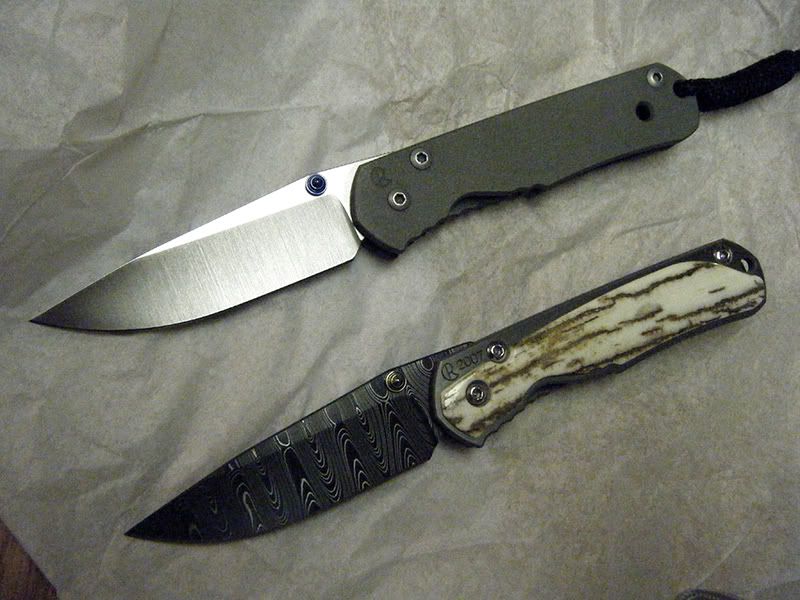

And here are the 800x600 resized photos:
Thanks, Josh! If you look at the 3rd, 4th, and 5th pics, you can get an idea of how much the knife has been thinned down in comparison to the damascus Sebenza. It's much thinner and penetrates and cuts phenomenally better, but it's not so thin as to be fragile. Use it as a knife, and you'll be thrilled with its performance.
