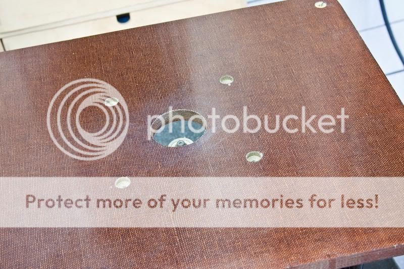

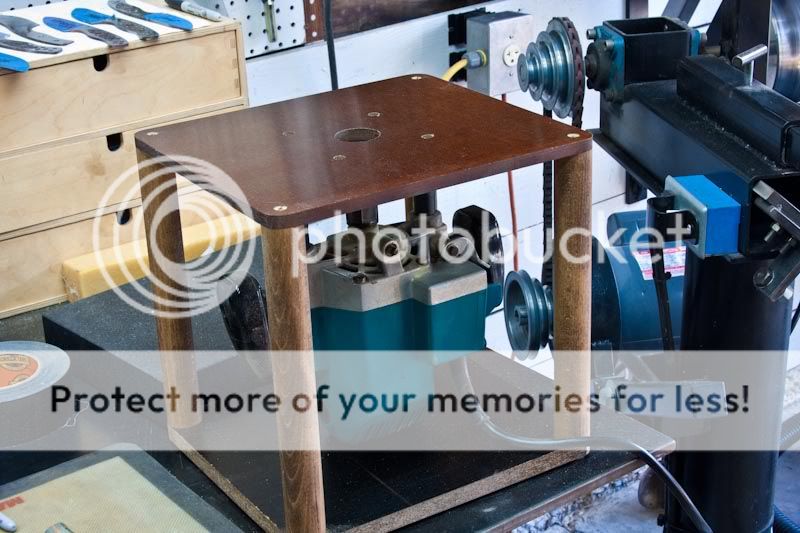

grizzled gizzard posted good info. I have a couple of Freud's and I had to experiment for the right size, but I think 3/16" was the one I like. I prefer a table versus holding a scale in one hand and a router in another, so I made one that works nicely for knives. I don't know if you want to make a table, but it cost me about $20 in materials and you need a plunge router, I think it is a safer option for an un-safe operation. I don't know if it's true, but when I was a kid I was told routers are among the most dangerous wood-working tools. I treat them as though they are. Table saws have to be up there as well...

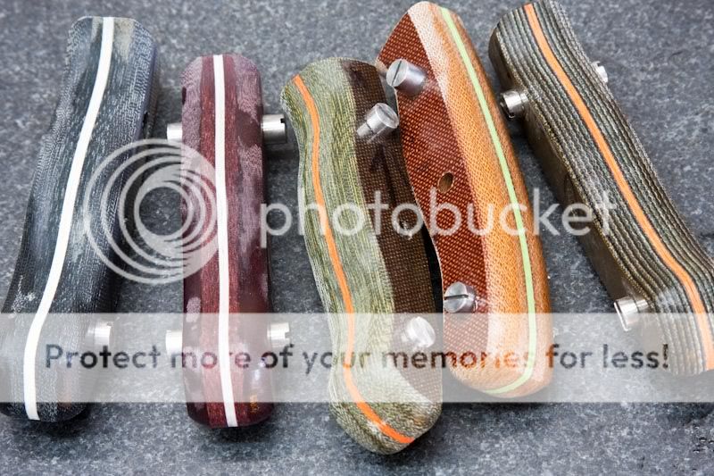

Here is the table with a Micarta top and closet rod uprights. Also, are some scales I practiced on. These particular scales did not need to be routed as I was going to hand shape them anyway, but it gave me experience for some textured G-10 I will be using. You definitely want to test on scrap with whatever you use.
