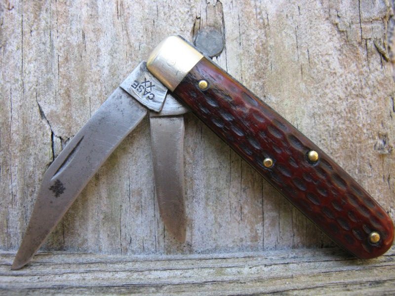

I picked up this Case XX 62024 ½ Barehead Jack a month and a half ago, because I like the old red bone. At the price I got it for I knew it would have issues, so was not surprised to find that the clip blade spring is weak.
It holds tightly in place when closed and at the half stop, but not when open, and the spring sits a bit proud out of the frame for most of its length in all three positions.
In the second picture it is the secondary spring you see, as I had the blade a quarter of the way open for the photo, but you can see the main blade spring in the first picture.
Would Case even consider working on such an old knife? Have any of you sent similar vintage knives in for repair? If so, what has been your experience?
Im still trying to figure a way to fix your issue, could you post a picture of the backsprings from the back? I know for a fact that case cant replace any of the parts for your knife with original hardware, they state specifically that replacement is of current stock; however with that being said, if its an issue of grinding down a part or an adjustment of some sort, i think they could help. If you could post clearer pics of the issue it would be easier to diagnose

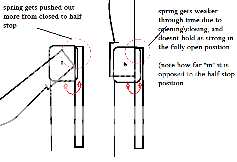

the problem with half stops is that the tang is ground square, instead of round (obviously), and the reason it's weak in the fully open position is because the spring gets pushed out further from the closed position to half stop than from half stop to fully open, i think a diagram will explain this better. So in the fully open position, the spring is under less tension than in half stop, therefore loosey goosey

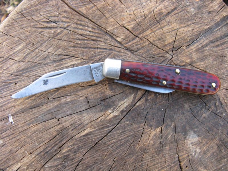

Here are some rudimentary pics to illustrate the issue.
After opening the clip blade it droops to this position.

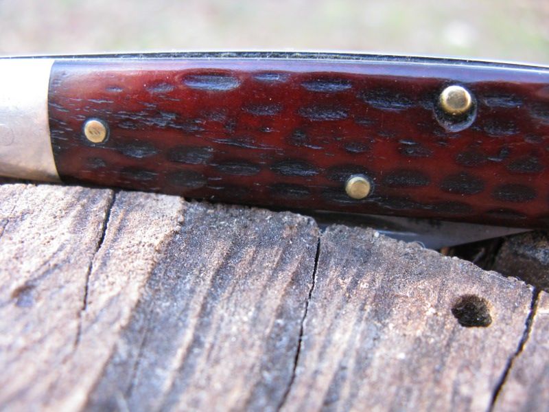

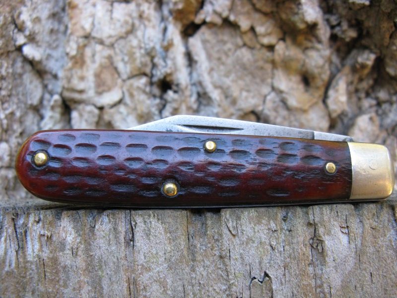

The next four are attempts to show the clip blade spring sitting ever so slightly proud in the closed position.
Looking at the knife from the pen blade side (looking across the pen blade spring you can see the clip blade spring slightly higher).
A close-up shot from the clip blade side.

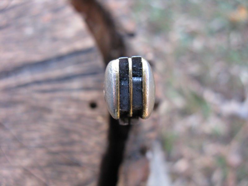

Looking directly at the pivot end, the offending spring is on the right.

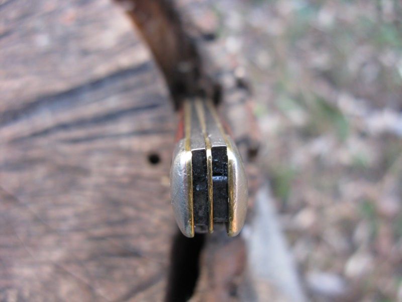

A slightly different angle, allowing a look along the springs.
