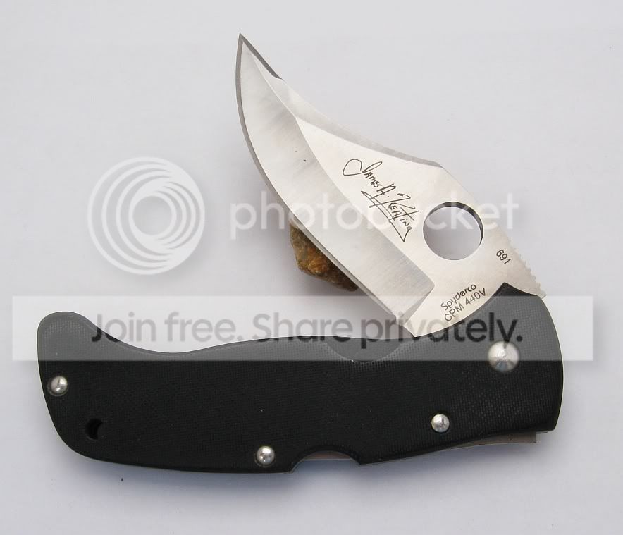

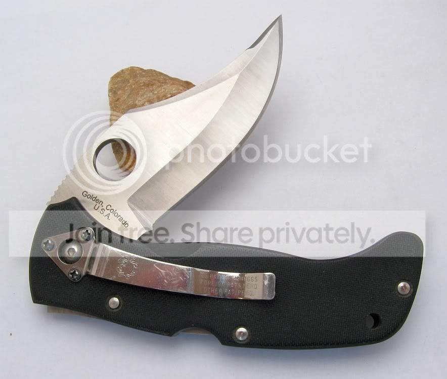

I put a little false edge on my Chinook 1 way back when after hearing that James Keating had one on his personal EDC. It’s slightly convex and just over 5/8ths of an inch long. When the blade is closed, it's completely covered by the bottom of the handle.
It’s not very sharp, but it can cut things like tape easily. I think Keating was probably interested in tactical applications, but it also works well for utility purposes. For instance, when you make a box-cutting type cut or want to put pressure on the point, you can just turn over the blade; you don’t have to awkwardly arch your wrist and arm to cut with the true edge.
