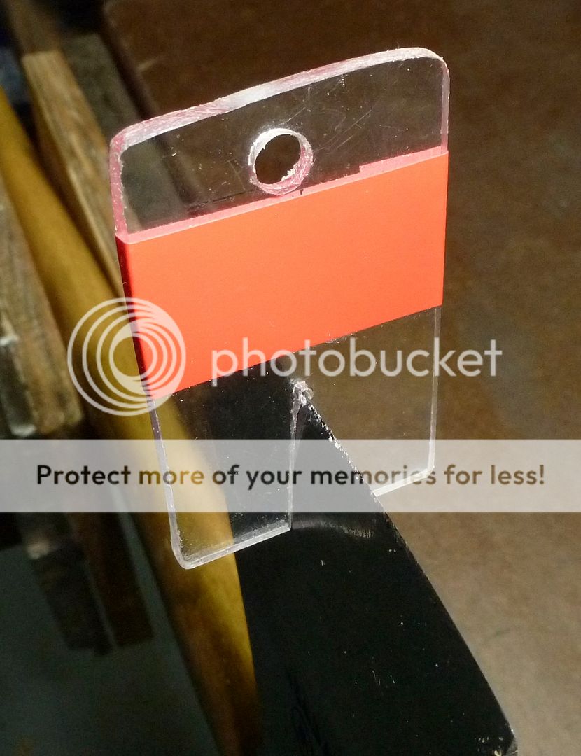

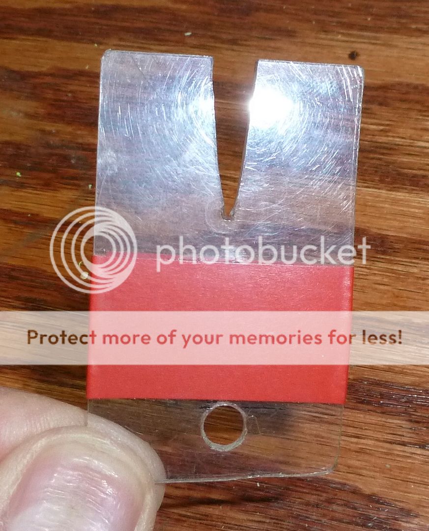

I'd sure like a metal one. I made one out of plexiglass and use it all the time to check my profiles. Traced it out of the book, but it came out a little narrow.
