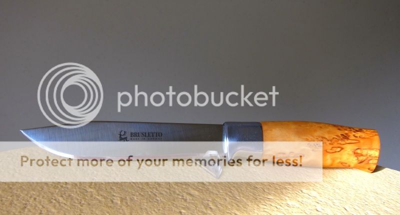

Thanks Paul. Yes some fixed blades would also be appreciated.
Brusletto Hunter (Norway)
Bonaj JR (Sweden)
~Paul~

And that Brusletto Hunter is beautiful! The wood is just gorgeous! :thumbup:
