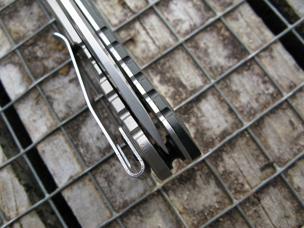

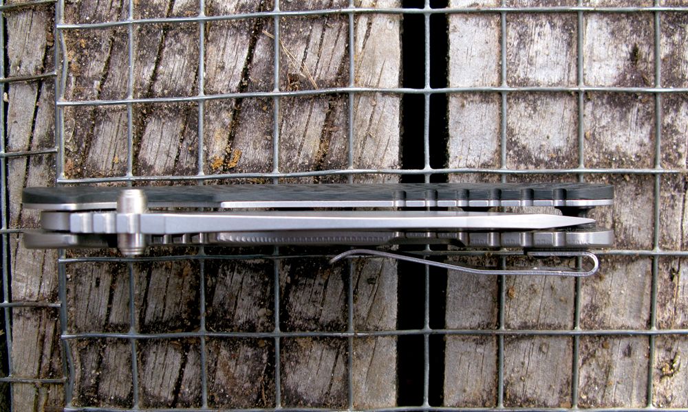

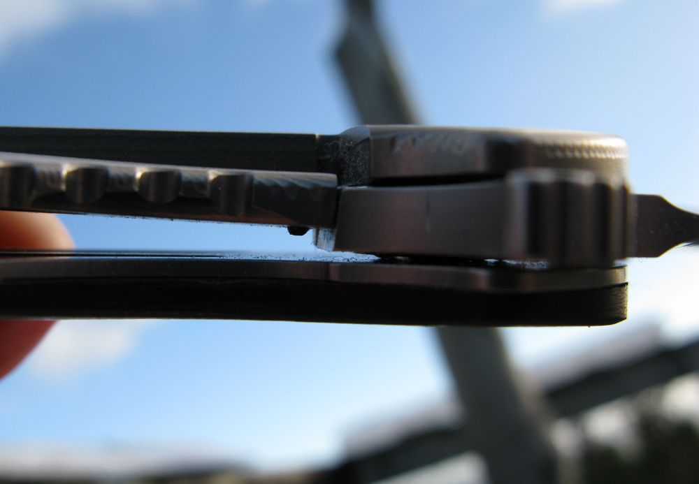

The blade on my 0560CFCB is off centre, I've tried all the usual tricks to try to centre the blade but nothing works.
Any tips or pointers?
It has also developed a sticky lock, tried the pencil trick but the sticky lock is back. Thanks in advance.

Over the last two weeks the lockup has shifted about from 30% to 50% and developed the sticky lock, the blade has also moved further off from centre, I suspect this one needs to go back to base.
There were no loose screws causing this, I have of course loosened them all up trying to centre the blade, I've also flipped the ball bearing over to see if it that had any effect, of course it didn't.

The blade centring was an issue before I first took the knife apart.
I've since taken it apart again and reassembled with all bearing configurations possible, none make a difference.
What I did notice is excessive wear to the Ti lock side bearing recess, the steel ball bearings are wearing a channel into the Ti, it is not uniform wear. There is also wear to the tang on both sides and the steel liner. The Ti lock side bears the heaviest wear.
The detent ball also has a worn flat spot and a corresponding groove worn into the tang.
This knife, at 6 weeks old bears more wear than my main EDC Hinderer XM which I have flipped the bejesus out of for 18 months prior to EDC'ing the 0560.

That's really concerning. I never noticed had that problem with either of my 0560s. I would suspect that dirt/debris, and other small abrasives, worked their way in an slowly eroded away at the titanium via the grinding action of the bearings. Titanium has a rockwell in the 40s at best, I think. So I'm not surprised it would wear away before the bearings.
Call KAI and explain the situation. I'm sure they'll help you out.

I don't believe that a soft 440 steel bearing is significantly wearing channels into the titanium, the hardened Elmax blade, and the liner. What you're seeing is likely a bit of polishing of the surfaces, or as was said, some kind of abrasive contamination in the race area. The detent ball bearing a flat spot is normal, and it happens to all knives. If the detent functions, it's not an issue.
The detent ball flattened on all three XM-18s I've had. All of them. I also noticed the same thing at Blade Show when I asked to see the XMs of several USN folk. If you're not seeing that kind of wear on yours then it's unlikely that your XM is as used as purported.
If the centering is bad enough to impede the function, then send it back for repair.

Do you always have to respond with such a snappy know-it-all attitude? Stop making personal assumptions about irrelevancies. If Jay says the bearings are not wearing uniformly in the Ti side then who are you to say otherwise? I'm sure he can tell the difference from a "bit of polishing". And they're not "soft" bearings. Typically they're 440c and around 60 Rockwell.

Could it be that the grinds are asymmetrical so it looks off center? And sharpie trick is the way to go with sticky titanium locks!
