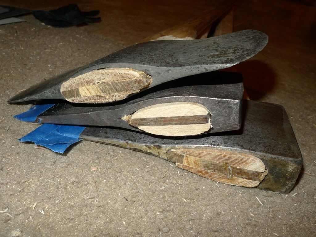

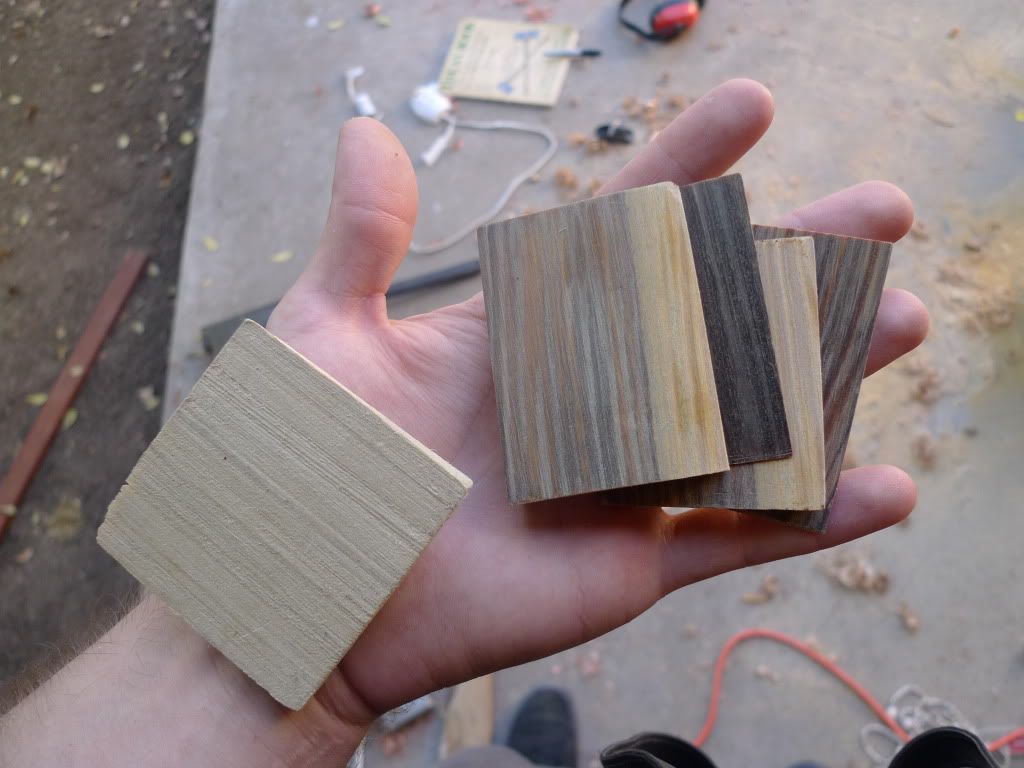

I've only ever seen wood screws in large quantity. I just re hafted 5 axe heads and made lingum vitae wedges for all of them. They weight twice as much as the pine wedges that came with the handles, 0.4oz (12g) for the pine and 1.0oz (28g) for the lingum. It will make for fun drilling if/when I have to redo any of them. I tried to sink a simple metal wedge into one of them, but it kept spitting out before getting to the first step. I'd love to get my hands on the short 3 prong metal wedges wetterlings/gransfors uses.
lingum vitae...that's..."hardcore." Nice work. I'd love to try that. You may not need a steel wedge. Why not try them out without a steel wedge?
since I can't get one in that's the plan :p :D I'm hoping they do well without it. I've had lingum vitae shift and shrink on me before, but in a confined space thats under a lot of pressure I can only assume that they'll act like they do when used as ball bearings and exude oil into the surrounding wood, while only shrinking a minimal amount since their so dense to begin with.
