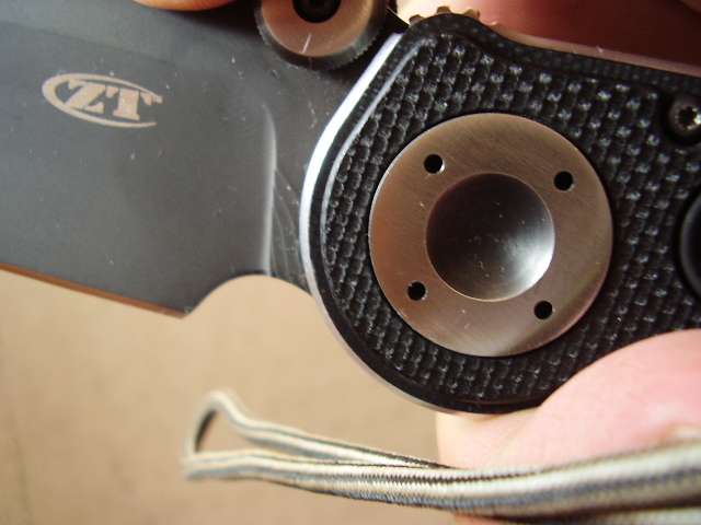

I'm a MUDD fan:D I have a stock version and the top one I modified to my liking:thumbup:, Stripped the black finish off the handles, stripped the clip and shortened it to sit in the recess, stripped the black off the face of the pivot bolts, stripped the thumbstud and carefully added a choil to allow me to choke up on my grip for some finesse work:thumbup:
One of my favorite heavy duty folders when workin in weather that sucks!!!

I love the look of the modded one very much! You did an awesome job with it. :thumbup::thumbup:
Moving the clip down between the ears/recesses really stabilized it in my opinion.:thumbup::)

Thanks cutter:o---it was a result of a cold winters day and an itch for somethin different:) I just can't leave well enuff alone. The clip mod truly did make the clip more stable.

Very nice Mod, love the look !
Ya man really nice job on the MUDD mods there. Did you do it all by hand with wet and dry?
Ryan and Kershawguy, thanks for the comments:o I used a stripper for removing the finish on the handles, then wet sanded with 1500 grit on the pivot/thumb disk & clip then used a dremel (very slow with water to cool the blade) for the choil. Also enlarged the hole on the clip to allow for a deeper seat in the recess which definately made the clip more stable:thumbup:

The more I look at that MUDD, the more I want to mod mine! If I had a second one that was mint, I don't believe I would hesitate.
How long did it take the stripper to remove the black coating?

Cutter, I used Easy Off oven cleaner:o It actually took a total of 10 to 15 minutes. After all the finish was removed I hit the scales with simichrome metal polish---it really made em pop:thumbup:

That is one very cool customized 0500. I really enjoy using the MUDD when I know I'll be getting messy with dirt/sand/mud.
