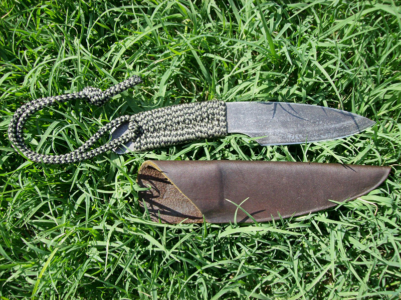

I masked off the edge. This is after about 3-4 passes of mustard 1-2 hours each set. One side came out better than the other. Getting the mustard thin is the key.
The top is a mustard, vinagar mix. Made it kinda brown patina.
the bottom grind line is mustard only. one pass, 30-45 min tops. i used, plastic easter grass to apply the mustard.
Looks even better in person.
Things i learned.
Sand it.
Wash it with soap. Prefer steel wool pad too.
Wipe with alcohol.
Apply mustard with a blotter. Something with texture works best.
Just cover the metal as thin as possible. Wet, and hazy film is enough. Where you * don't* see yellow mustard blobs is where the metal will darken the most. Like a photo negative.
If the reaction is working you will see blackening start at about 20 min or when it starts to dry.
You will also smell the reaction taking place...and it stinks.
if you don't see significant patterning developing, you didn't clean or sand the steel enough.
If you hurry the reaction with the heat from a hairdryer, you can even see the black pattern walk across the blade.
All in all i was very impressed with how well this worked, and how little mustard you need, a restaurant size to-go package should be enough for one kuk.
Vinegar didn't work as well as mustard only for me.
good luck
And having sanded my mistakes away on this, i can say the patina is pretty tough also.
