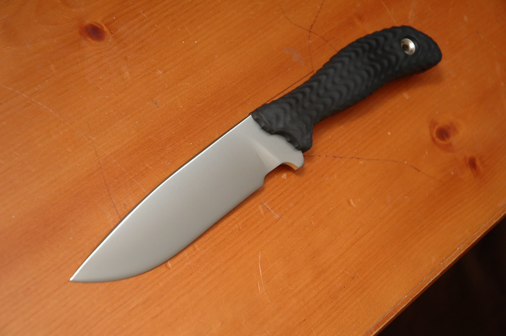

Edit to add - This pic shows the LE and SE models.

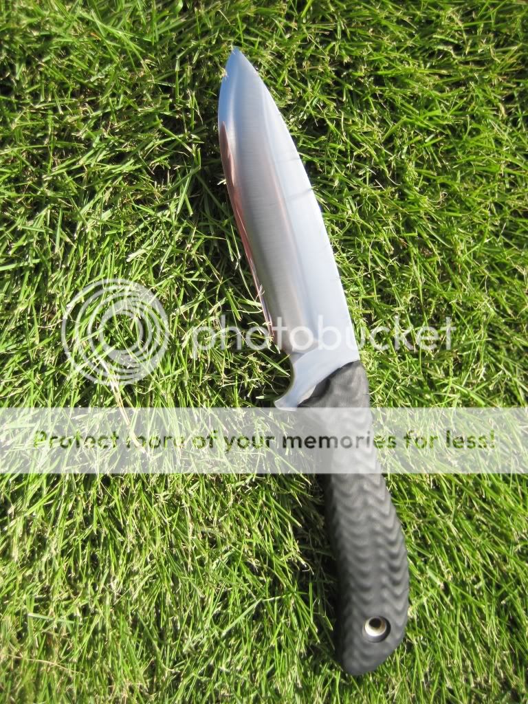

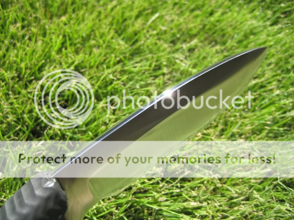

I have actually stripped and convexed two S5CG's. One for myself and one for a friend. However, I didn't full height convex my blades. I wanted and left the saber grind on both that I did.
Full height grind would thin out the over-all blade and make the blade a bit more of a slender slicer (more like the Bog Dog), but the blade should still be plenty stout and tough for most uses of a knife of the S5's size (still thicker than the Bog Dog). I already have a Bog Dog, so I wanted to keep the thicker saber grind for variety and seperation from my super-slim/super-light Bog Dog. IMO, the S5 is not a prybar styled knife. But, a GREAT knife and great tool. So, if using for cutting, a Full height convexed blade on the S5 should be fine and arguably better in some ways. :thumbup: - these things always have some compromise.
On obth of the two I did, I removed the ramp, rounded the choil and blended (reshaped) the index finger portion of the Res-C forward into the back of the metal portion of the guard for closer more natural and balanced feel (IMO). - Basically, I removed the "Nub" of Res-C in front of the index finger and created a "single" guard of Res-C blended into metal guard as opposed to the double bump - effectively double guard of Res-C and metal.

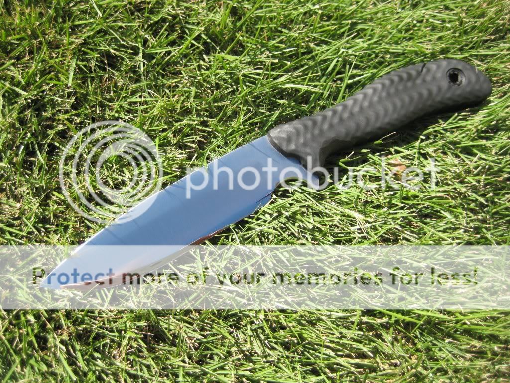

Here is the one I did for a friend (prior to flared tube being re-installed):
Here is mine with a bit of a drop to the point (I think the above version came out nicer - I removed the Res-C handle on the above knife to be able to do better work. But, I did mine first and I did not remove the Res-C handle on mine - which results in a slightly lesser quality end result - especially at the ricasso. Now I feel I need to work on mine a bit more. :o ) - However, they both "WORK"/function/cut VERY well and both feel great in hand. I like the S5 a lot. But, I am partial to satin, convex edges, rounded choil and no ramp. (.... and I prefer the Res-C modification as well.) :

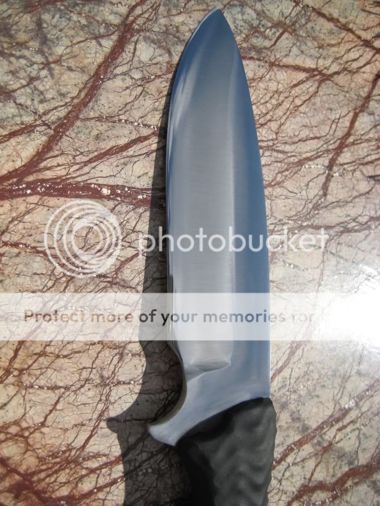

Ban did a full height convex. His work looks PRO-fessional. I think my home-hobbiest-hack work comes out decent, but "looks" home-hacked compared to Ban's.
Ban's:
Ban's blade and edge both appear to be thinned a fair amount. His edge looks to have a thinner convex than mine. I am sure Ban's edge cuts VERY well. Mine may not be as thin, but I know mine cuts VERY well. SR-101 gets WICKED sharp. :D
