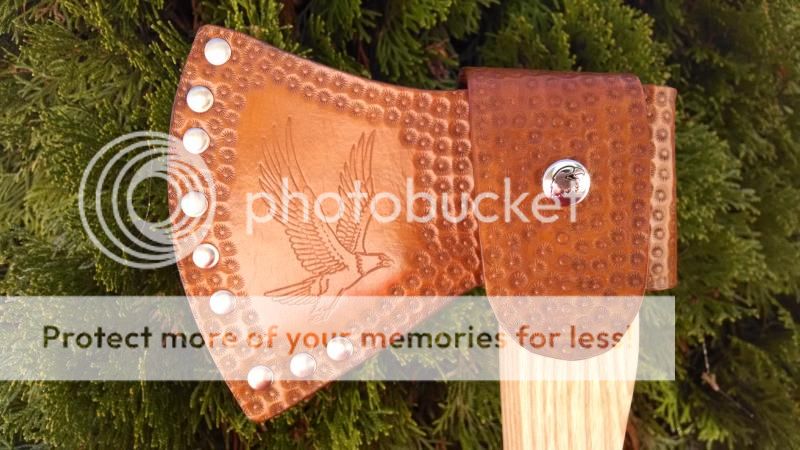

I picked this one up a month ago or so at my local saw shop for $29. I confirmed it is German made by contacting Stihl directly & after some digging found out it is made in Germany by a company called Helco. Anyways the first picture is a stock one taken from Stihls website as I forgot to take a before shot. A friend of the family does leather work as a hobby as he is disabled & retired. He wouldn't take any money so I gave him free rein to make it however he wanted. Little bit gaudy but i like it. It works & I really appreciate the time he put into it. I also hated the orange handle & varnish they had on the rest of the handle so I sanded all that off & put about 3 coats of tung oil on it. Haven't touched the head yet so that will be next. Enough talking so I'll post a few pics I took this afternoon.

Gransfors who? Seriously though, I'm surprised that I don't hear more talk of these. I like the look, the price is right, and I am going to make an assumption that the steel is good. Have you used it much? I'm going to look into reviews of this, thanks.
BTW, I also think that the sheath is seriously awesome.

Very nice sheath. Your friend does very nice work!

Your friend has the small Helko sheath, right?
Yes he does I'll get a picture of it on his Stihl hatchet tomorrow. I didn't take offense to what you had said & I've heard a lot of good things about the husky hatchet. I was very close to buying one & might still just so I can compare them. :) What I really want to try out though is one of the H&B forge camp axes.
