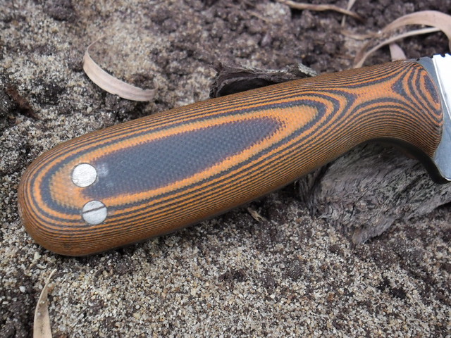

Some of my Becker G-10 crap:
004 by CamH_16, on Flickr
Close up:
033 by CamH_16, on Flickr

haha! thanks Camh_16! i was writing as you were posting those out! Looks great! Found g10 @ premiumknifesupply.com. Its straight black sheets, but i think that would work for me.
