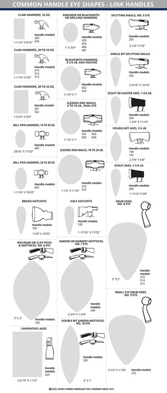

What is the weight of the axe head? You need to measure the size of the eye, but probably safe bet would be to buy pick axe replacement handle and whittle it down to right size. Just make sure to pick one without any runouts.
Check #6 and #7 mattock replacement handles eyes
Thanks that is a very helpful chart. Looks like I'll be doing some moderate shaping with most all of the options but the less the better. Planning on hitting my local hardware store with the head in hand and see what looks the closest. Do you think I should looking in the 24" realm in regards to the weight of the head?
