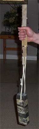

I have been working with it recently as I will be making stone/copper/bronze axes/knives (or plan on it anyway), so need it for attachment. I have tried a few recipes and it is easy to get high bond strength :
http://i7.photobucket.com/albums/y269/CliffStamp/swamp rat/ratweiler/ratweiler_pitch_strength.jpg
That is a 25 lbs lead weight and the glue holds the wood together easily, I even snatched it fast and just cracked the cable. However it will still fracture readily under impacts and based on just whacking that stick around I don't think it would hold up under axe/arrow impacts.
Has anyone one done this and have any details on the exact recipe, common are 5:1:1 for pitch/ash/tallow. Does how long you heat it make a difference, can you overheat it, does the type of ash or pitch make a difference? Could you improve it by adding fish glue which is generally more runny so it could give maybe a san-mai type deal?

Gather the pitch from the bark, you can crumble it off with your hands or scrape it off with a knife. If it is a fine edged knife you might want to carve a scraper as it can be difficult to get off the blade, for large choppers I just leave it on and let it wear off.
Put the pitch in a tin (or on a rock) and put it next to a heat source until it melts, now pick out and debris. Add powered ash to the mix (and lots of other things like grasses / scat can be used as well) stir it well. Now dip small sticks into the glue and roll them to get a coating. As they dry they can be redipped to get a thicker coating.
You just heat up the pitch sticks to use, you can also let the glue cool and roll it out with your hands into sticks and then carry them or pieces. There are a bunch of pictures in the ratweiler review which is in progress.

You can infact heat it too much. This causes the turpintine to come out of it,or so I'm told and a double boiler is recommended. (I just heated it in a can). As far as the recipe goes it seems to be a bit of witchcraft.
The amout of tallow being the ingredient that matters most. Too much and it stays pretty sticky in the heat of a summer day, too little and it gets brittle. I used wood charcoal crushed for the binder and I kinda liked it, but want to use willow char sometime as it is finer than the boxelder that I started with.

The stone blades were attached with cord as well as glue, my question was in the inconsistency of the two methods of attachment as pitch glue is really brittle based on what I have seen, so I was wondering if there is a way to make it much tougher for certain applications.

Grind up some eggshells into powder and experiment with different ratios mixed in with the pitch (during heating in its liquid state). Try starting with 1:4 (eggshells/pitch). Eggsshells will give the glue some "flex" and reduce the brittle nature of the pure pitch. You can adjust as needed, and experimenting will give you the optimal ratio for your needs.

Thanks for the links, there seems to be a lot of possible mixtures all starting with a basic sap base. I have lots of pitch, lots of wood, I'll try experimenting with various mixtures and examine the strengths and impact resistance.
