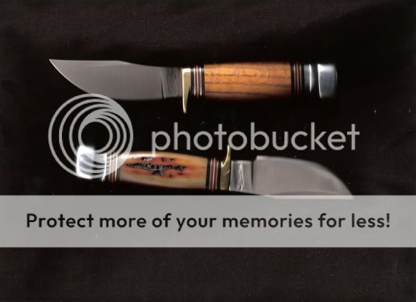

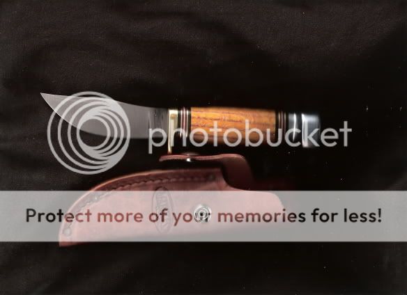

I got my new marbles today,thought I'd share a couple pics,really nice oak in the handles,nice sheath and sharving sharp out of the box.:thumbup:
Also threw in my bone handles trailcraft just for comprison.
Thanks for looking!:D
