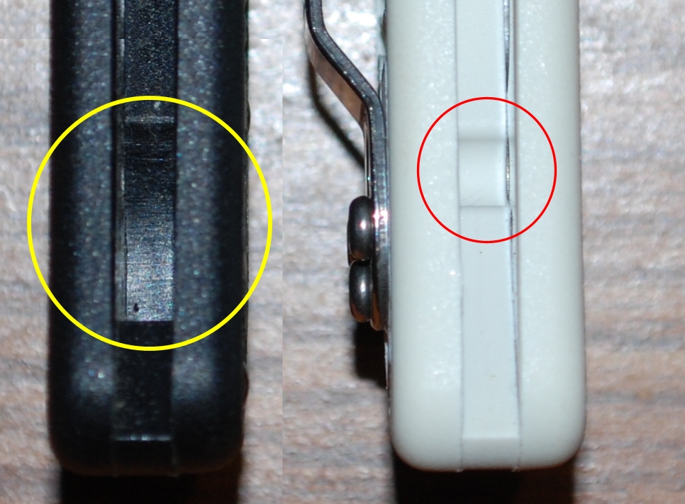

The only caveat would be that Endura 4's made before the Matriarch 2 was introduced have a small semi-circular "notch" in the backspacer for the lanyard hole. The Matriarch 2 handle, and those of Endura 4's made after it was introduced have a much larger "notch", to accommodate the tip of the Matriarch 2's blade. The older Endura 4 backspacer can probably be modified, but would need to be in order to use it with a Matriarch 2 blade.
