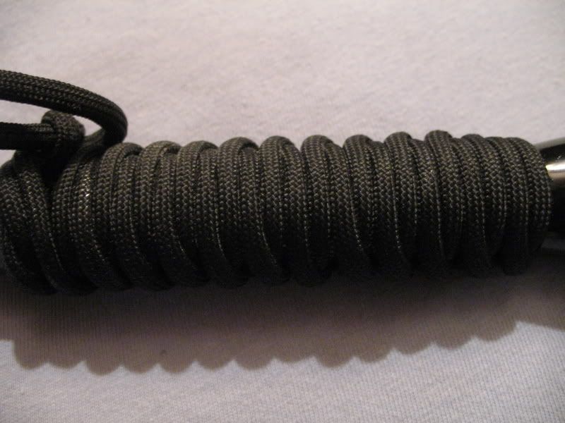

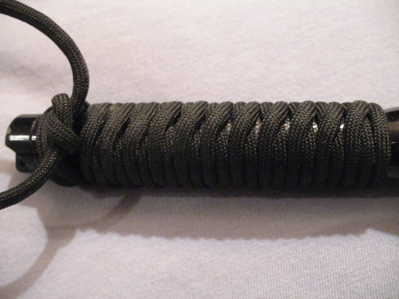

it's really not hard. you just have to take your time, be patient, and expect to try it a couple times before you get it just right. i haven't wrapped a knife yet, but just for practice i wrapped a mini-maglite. took two tries, and i'm pretty satisfied with the result. just make sure you get the wrap as tight as possible.
when i wrapped it, i made sure that on one side i always crossed left over right, and on the other side right over left. that way, it stays symmetrical, and each new wrap seals the previous one. i guess it's kind of like a bunch of clove hitches. i wanted to keep a lanyard from the left-over paracord, so i started the wrap at the light's head with the middle of the line, rather than at one end.
