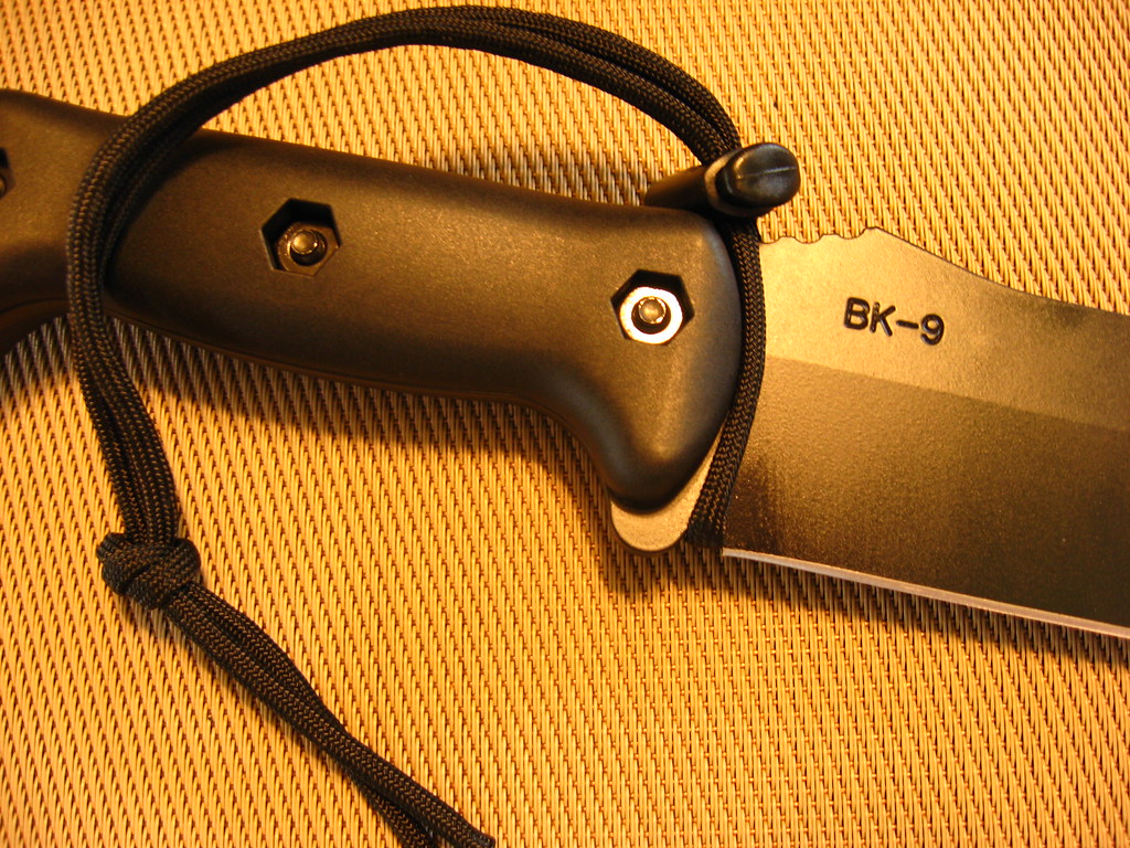

I would like to modify my BK-9 (maybe my BK-2 as well) with a special lanyard hole at the top of the blade by the front of the handles. I liked the way this guy ties his lanyards, and think it would make for a very safe handling option while chopping and bushwacking in the woods. Take a look at the way he does it:
http://www.youtube.com/watch?v=UU__hqhUM6Q
So I would like to drill a hole through this thick bar of 1095. How hard will that be? Anyone try doing this with their Becker? Do you think a standard metal drill bit will be able to handle it, or would I need something stronger?
Design wise, that would be the safest place to put a lanyard on a large blade or machete. Well actually about where the third bolt hole is, the one closest to the blade.

If you drilled the hole in the scales parallel to the blade...on the front side of the scales, more of a notch than a hole really, you could use the existing skeleton holse in the tang.
you could probably make matching "liners" that install under the scales, and are extended to allow you to have more of a "guard", and put the hole through THAT (with a spacer).

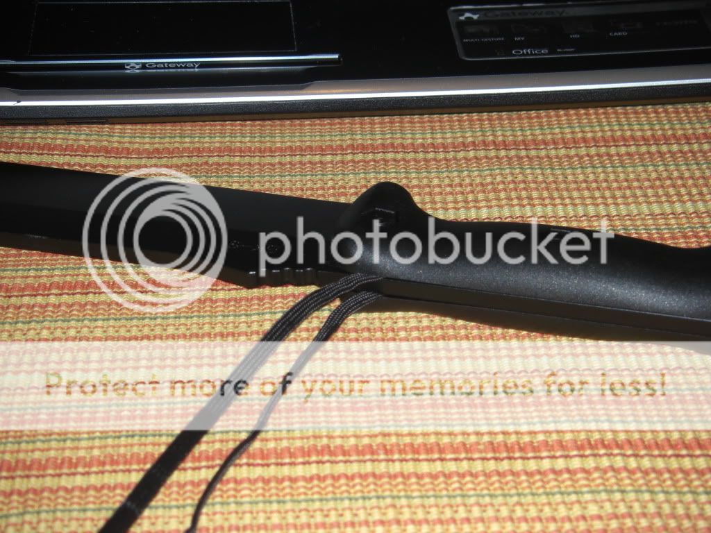

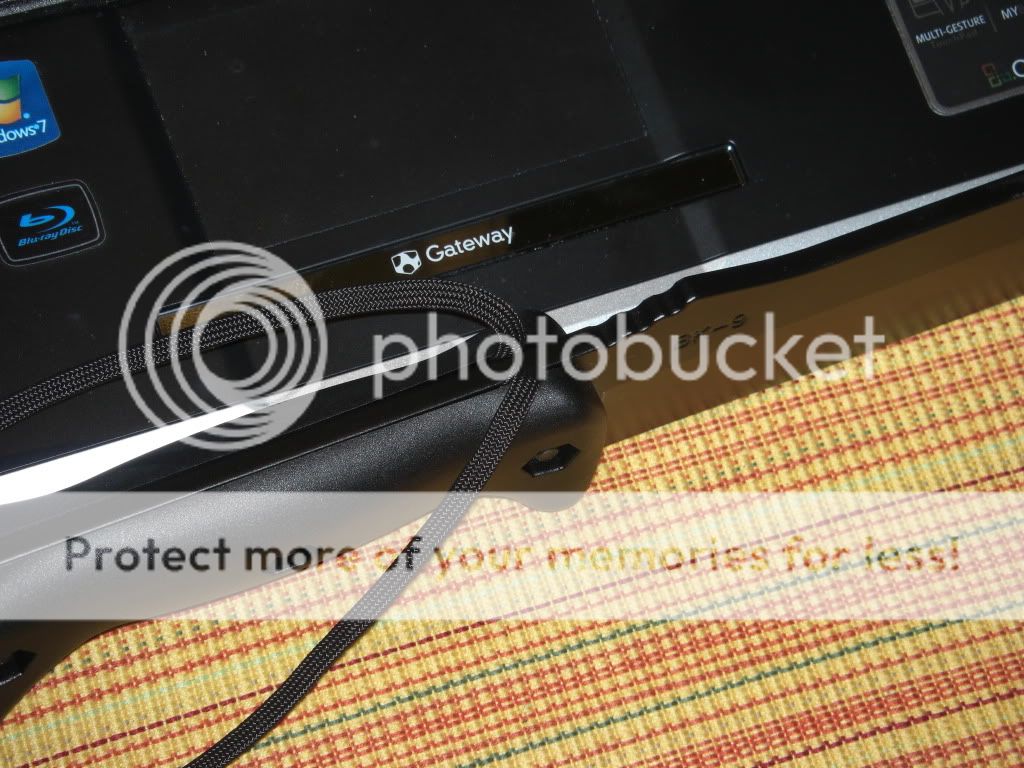

as well, there are probably ways to figure out how to get a piece of small paracord loop under the scales on both sides around the forward screw, and give you JSUT enough of a place to slip a lanyard through - as with what slapper said now that i review, but you might not even have to drill to try it out
I'd say go with gutted paracord like bladite said. I tried this and the gap isn't too big, I can hardly feel it.

Been doing some chopping with this and it works. Try it before you drill anything.

Arkanian, yes it's a cordlock and a piece of 550 that I keep in the pouch. When I'm chopping, I slip it on. It works for me.
