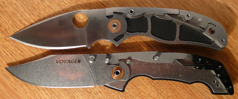

Stop pin version:

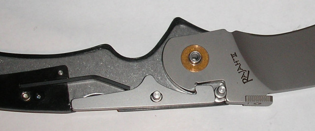

Lock bar version:

The Tri-Ad lock has a small stop pin down inside the handle that's supposed to prevent this; it keeps the blade from closing far enough. It almost looks like someone at the factory left it out on yours. Definitely contact Cold Steel (phone is the best way).
edit: A couple models with the Tri-Ad use an extended portion of the lock bar for the same purpose. Not totally sure which the Code 4 uses, though my money'd be on the stop pin.
Stop pin version:
Lock bar version:
s640x480
Look at the difference between the lock engagement on the Spyderco and the Cold Steel. It is pretty significant.

Code4 uses the stop pin (as described and shown above by G. Scott H of the Voyager). Have you had your Code4 apart? If so, you may have neglected to reinstall the stop pin.
You can see the stop pin with the knife open (it's up by the rounded portion of the butt of the blade when opened). Shine a flashlight in there and see if it's there. If not, that's your problem. Having CS ship a tiny stop pin replacement would be considerably less expensive than shipping the whole knife back and forth.
