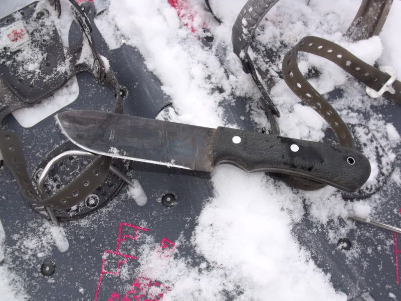

This season, my JK-AK has been my go-to belt knife for snowshoeing excursions, where it frequently spends extended periods of time in a sheath half-filled with snow and pine sap. I gave it a cold blue coating at the start of the season. While it certainly doesn't rust proof the knife, it does make it a bit more rust resistant in the short term, which is perfect for my needs. I can hit the trails for half a day and not worry about rust spots. Of course, good post-outing maintenance is key. Here's a pic!
