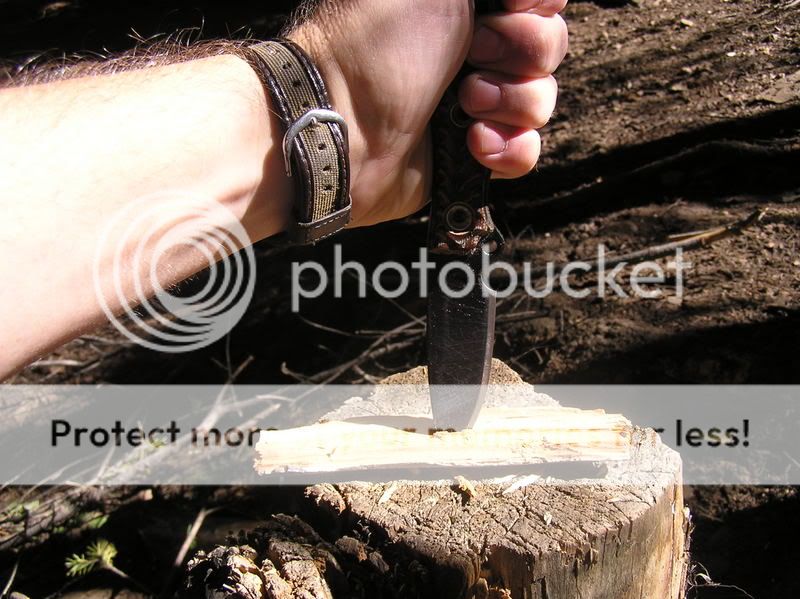

I broke the tip off of a Delta Traveler.
A couple of years ago, I butchered a a hog, including tapping it lightly through the brisket and through the pelvis with no damage. I went camping the next weekend, and was attempting to split some small fatwood sticks with it. I put the fatwood on a tree stump, and then put the DT on top of it, pointed straight down, tip first. I was lightly (and it was light) tapping it with the heel of my hand, and I lost the last 3/8 of an inch of my tip. I finished the job with a Busse Active Duty. I later re-ground the tip so it has a little more drop, and is a little thicker. It's not noticeable unless you look closely.
Here's the offending wood.
I was very surprised by the break, but this knife does have a very thin hollow grind, especially at the tip. I must have hit some waviness in the grain of the wood that deflected the tip sideways "just enough". I didn't think I was abusing the knife, but oh well, lesson learned. What I was doing was outside it's intended scope of work. I still think Doziers are some of the best knives out there, bar none. If I ever use this knife like this again, I'll lay it down edge-first, rather than tip-first. It never ocurred to me to send it back in, 5 minutes on a belt sander did the trick, plus, it was 100% my fault.
I now use Doziers only on animals, and other knives for wood, except for my Pro Guide. It's thick enough to handle this kind of work. So I would say, listen to your gut.
The hog didn't produce any noticeable dulling on the Dozier, by the way.
