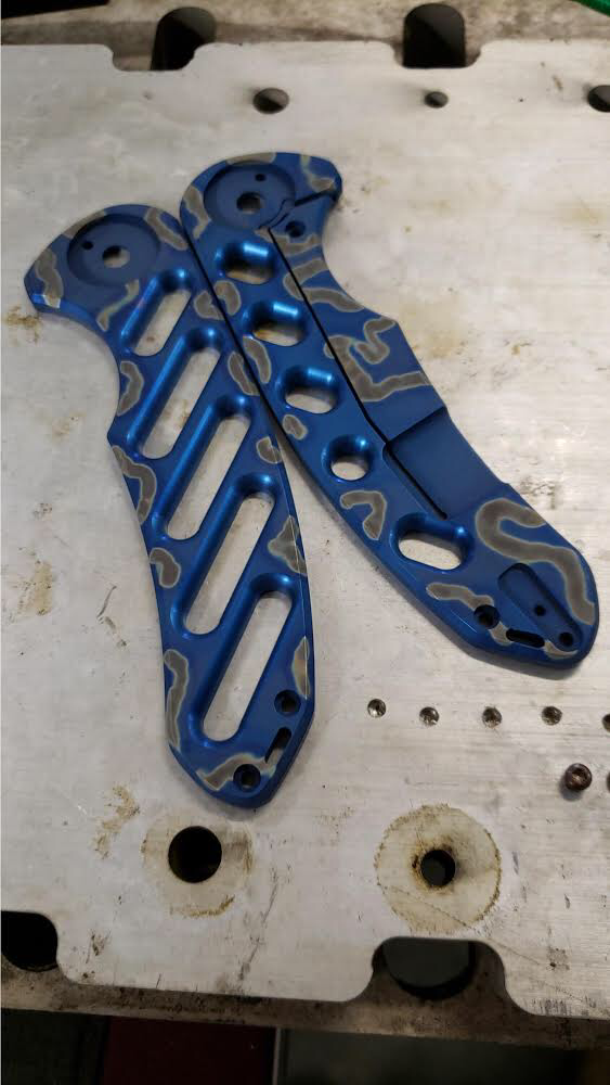

Good question, I just purchased a Large F3 that will arrive Monday and would like to know if the pivot is captured on one side. Here is a pic of my knife scales. Looks like the pivot can be installed captured on either side “if” it has a captured pivot.

Is the small off-axis hole in the cutout used to stop the pivots from spinning?
I have the same scales...but plain/tumbled. The cut-outs save so much weight!l!!
I know, looks cool and saves on weight!. Can’t wait to get mine this coming Monday! Think I might have me a compact made too, lol.
Funny thing I noticed in the Vid is that the female side of the pivot has a counter-bore and the stop-pin for the blade has a longer side. The longer side was installed toward female side of pivot. Not sure if that was supposed to capture the pivot to stop it from spinning or not. Guess I will find out Monday.
