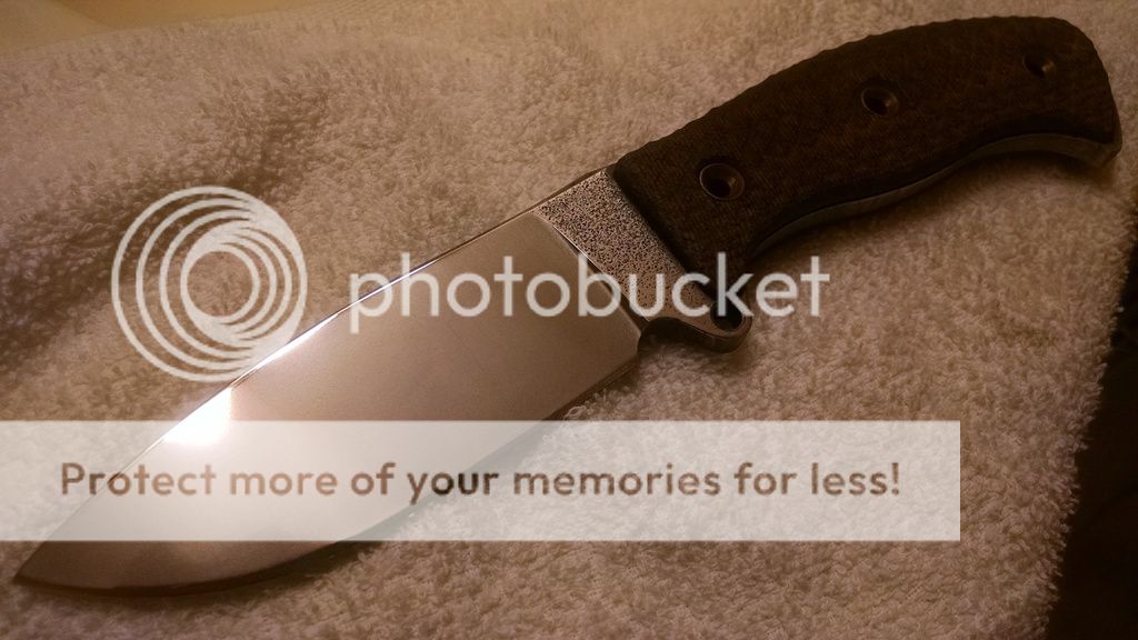

Did it by hand with a piece of leather belt glued to some wood. I just found a tutorial on YouTube and took notes.

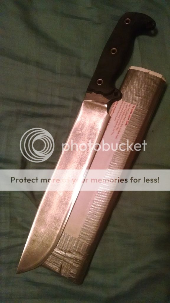

Unpolished satin. I believe this is 800 grit (?)
Ergo Badger polished to 8 micron or 2000 grit
That looks awesome Terry, might have to try that myself in the future. Thanks for the pictures.
Thanks buddy. Based on my experience id suggest a more supple piece of leather- mine was stiff, and therefore I think the finish is not quite uniform- some small areas got less of the sandpaper hitting them. It was my first attempt though and it was a fun learning experience with a decent result. I went from 220-1500 grit, going up by 200 at a time essentially.
Nice satin on that Battle Mistress Timmy. And I love the polish on the Ergo Badger. Thanks for the info about the polishing process Terry.
