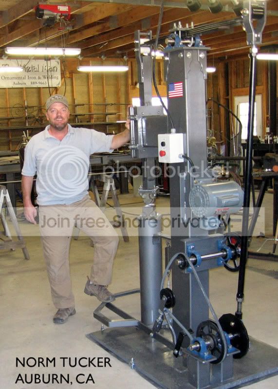

I am looking to tackle a power hammer. I was looking at the Appalachian power hammer plans, and think it would be great fun to tackle an improved version of this. Has anyone here done this? I know i will have questions along the way and don't want to look too much like a dumba$$ asking them. I am thinking of doing a 50# hammer( I have ALOT of large pieces of S7 and O1 to play with.)
I want to make several sets of dies. I have a 3" diameter bar of 52100 that is 6' long, probably going to cut and weld those up with some gussets to make drawing dies.
What other types of dies are there? I understand the flat, standard dies.
Do you think a 2hp Baldor motor will run this without too much trouble?
Here is a pic of kinda what i want to do. Then maybe i can forge down some of that 52100....
Any input is greatly appreciated

I have seen the hammer in your picture run and man does it hit. He is working on a very detailed set of plans for the exact hammer you see. He has gotten a lot of calls on it so he figured there would be interest in plans. I was going to build one myself, but found another homebuild for sale cheaper than I could build one for so I just bought it. If there is interest in plans, I could contact him and see where he is at on them. I have no stake in his hammer plans and don't benefit at all so I hope this isn't considered an advertisement. I just know that his hammer runs great and hits hard.

Yeah i might be interested in a set of plans. It is a great looking machine, and i need to get a hammer, my shoulder is kinda beat up from sports and such so the hand hammering needs to be kept to a happy medium lol.
Check out www.iforgeiron.com and take a look at the hammer section. You'll see plenty of homemade hammers. Many of which were built for less than $100..Now if you make one real nice one its gonna cost more of course. 2hp will run a 100 pound homemade hammer no problem. Ive seen several 50 pound hammers run on 3/4 hp motors. The heavier the flywheel the easier it is on the motor.
