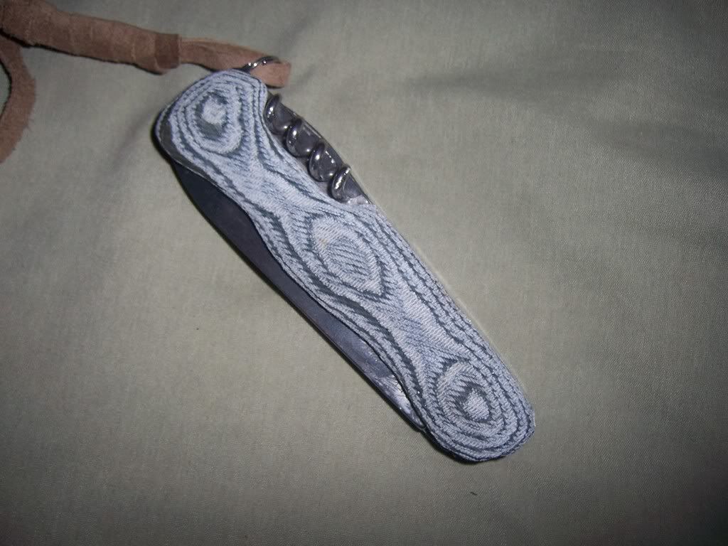

I do them, I really hate cellidor.
Micarta,
Wood (oak),
It's not hard but you absolutely must own a dremel. The way I find easiest is to get a slab of material, put lipstick or something similar on the pins of the sak and press it down onto the slab. then just drill the holes where the lipstick is and epoxy it on. After it dries use the dremmel to cut it flush the the liners and shape it.

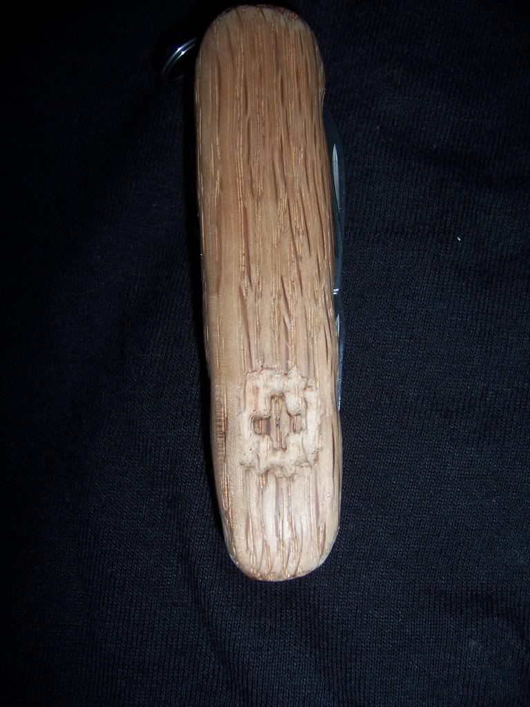

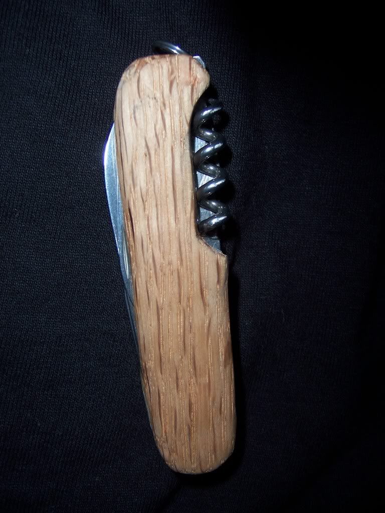

I've re handled a Recruit, and a wenger esquire in oak, not to hard, just takes a little patience :)

i took each handle slab, used them to mark the wood slabs and cut out the wooden slabs, i used the sander to shape the slabs some, i used oak to rehandle a GAK. once you have the shape you want, then mark the protrusions with a grease pencil, and transfer to the handle slabs, make cutouts with your dremel, then epoxy the slabs onto the knife, i do this with the blades open, i finish sanding and staining the wood, and you are done. takes a couple of days use long setting epoxy as it tends to be stronger rather than the 5 minute stuff.
