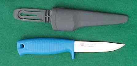

Tanto tips with straight surfaces and sharp corners have disadvantages. When you are skinning you generally try and separate tissues along their natural boundaries. The sharp corners tend to catch and cut things you were trying to keep in one piece while the flat edges tend to go straight even when the tissues margins are curved. A shorter blade like the CRKT M16 is pretty controllable and will work ok. A long blade like the Recon Tanto is going to make your life difficult. A compromise between a drop point and a tanto blade contour is a straight back blade like a Mora. They work well for a good price.
