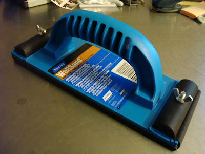

I don't mean to get to far off topic but here is what I use. It is a sheetrock sander from the hardware store. The handle makes it easy to hold and the paper is secured wth two clamps over a pad. It cost about $6.
