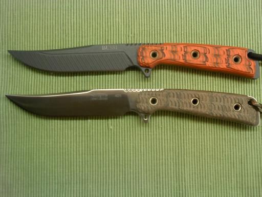

Does anyone have a pic of an original HG55 that is mentioned in the Busse add above? "The Old School One"
These look pretty close to whats on the screen shot.
Sorry for the crappy cell phone pic.
I'm refering to the early 1990's version Boss Man is mentioning in the add that the newer version is patterned after. I'm pretty sure your two beauties are the later release. I'm not positive but I am pretty sure. Does any one know? Sorry not trying to highjack you thread B.
I thought they couldnt polish the CBT bevels. They sure look polished to me:confused:
You can polish anything with enough effort lol. I think they just don't want to polish certain grinds (ie: CBT) because the effort it would take would make it difficult to keep the price down for the consumer. To my knowledge, these are the only CBTs that were sold as a satin/competition finish hybrid (though up close, the finish just looks satin IMO). I'd love the chance to buy another, but havn't seen ANY on the exchange since they were originally offered.

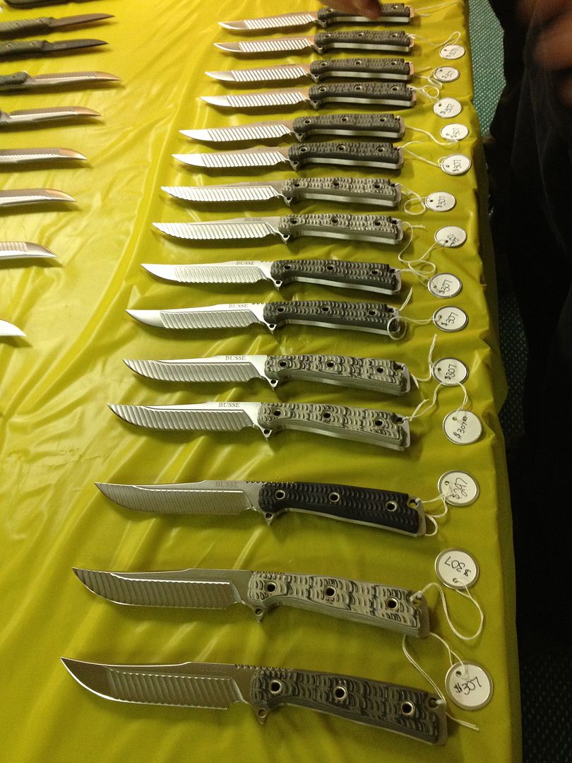

Those HG55's with the smooth tips and CBT's behind them are really sweet! :eek:
Vertical CBT's like on the HG55 would be much easier to do than horizontal ones on the other blades that have them if you are trying to get all of the decarb out of the grooves as you don't have to worry about hitting the handles, but if the handles are removed or not yet installed, it shouldn't be much of an issue either direction.
