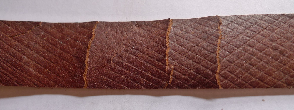

It was sharp enough to split a special leather and then suddenly it decided it didn't want to anymore. I try to remove as little as possible, but at a certain point. It breaks the pattern on the top of the leather

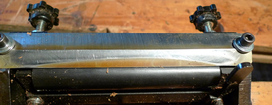

I been trying to sharpen the blade and it does shave hair, but it's still not working with this leather. Cuts other leather fine.
It also discolored for some reason as you can see.
There is a small warp on the underside. Flat on top. Someone mentioned on a leather forum that the blades are like this and flatten out when clamped it.
I'm using Japanese water stones. I sanded the faces to make sure they're flat and still won't remove the shaded area.
Was thinking about have someone grind the underside to flatten it, but not sure what to do
Picture of the blade and what it did to the leather (which is quite old by about 230 years)

Don, I'm far from an expert on things like this, and looking at photos is also far from the best way to assess a situation, but it appears to me that the leather is the problem and not the blade. If the leather is as old as you state and based on the dried and degraded condition it appears in the photo I doubt that even a brand new, unused blade would do the job.
It's probably time to look for "plan B" for your project, because I don't think anyone could split that leather successfully.

Two separate problems. A warped blade is no good for anything except giving you a headache, the sharpening pattern on that is not usable. If the leather cannot take being rolled through a splitter how is it supposed to stand up to whatever use you are building it for? It's old, really old actually, and the top grain is brittle. I certainly would not be selling anything made from it.

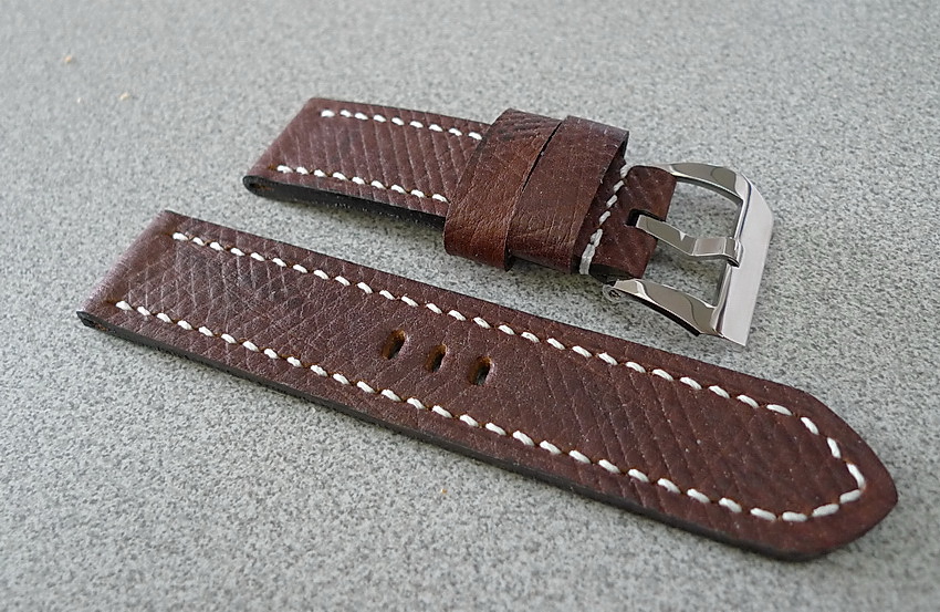

I had about 100 straps made by a supplier I used from the previous hide and no problems and I've hand made about a dozen.
Leather is also used for custom hand made shoes
Leather is not stiff, but problem may be with the pattern that weakens it. I have another new leather with a patterned design that also doesn't like the manual splitter

Just heard from Tandy and they don't sell replacement blades. Just what comes with the splitter.
Tried 220 grit and did nothing
Going to have to call around and see if I can get it surfaced ground and trued at a reasonable price.
I have that splitter and had essentially the same problem. Skystorm is correct about the bow being a problem for a couple of reasons. The biggest is that you are not getting it sharp there when sanding on a flat surface. It will also cut a curve and will tend to go deeper. To fix mine I taped sand paper on my surface plate and sanded by hand until I had uniform marks across the surfaces (top and[/U bottom)]. It took quite awhile and a lot of various grit paper but eventually came out razor sharp and cut well. Since then I obtained a surface grinder for my folder work and use that to sharpen now when needed. Usually, a simple stropping after every few jobs keeps it sharp a long time. If a shop will do the grinding for you I would jump at it and then just keep it stropped to make it last.

I make watch straps, so a little out of my price range and widest I need to split is 1 3/16" as that's the widest piece I need

I taped sand paper on my surface plate and sanded by hand until I had uniform marks across the surfaces.
Randy
I tried it with 220 wet/dry, but didn't do much. As the blade isn't flat wasn't getting a uniform sanding. Didn't do much to the center of the blade face
Was also rubbing my fingertips a bit raw also if they slipped down against the paper

I've never used a splitter before but that blade resembles a planer blade. I sharpen my planer blades and jointer blades in my own shop.
You may have a local wood worker who sharpens their own planer blades. They may be able to sharpen yours.

Took it over to a shop that surface grinds and going to cost $100 to true it. I'll finish it on my water stones to hone the edge.
No buffer. 1000 and 6000 grit stones
Hopefully it will work when I pick it up at the end of the week as the guy only grinds s/s. He said he's never done tool steel
